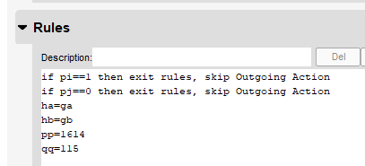

Actually I can’t figure out this MIDI Buddy problem. MTP is returning the mouse to predetermined locations instead of the last known cursor position. Something has made the ha and hb variables a certain number and they won’t change. Every one of these mouse click and return sequences uses those variables.
MB Log
This is the first translator that captures the mouse position and tells the mouse to click somewhere.
Click

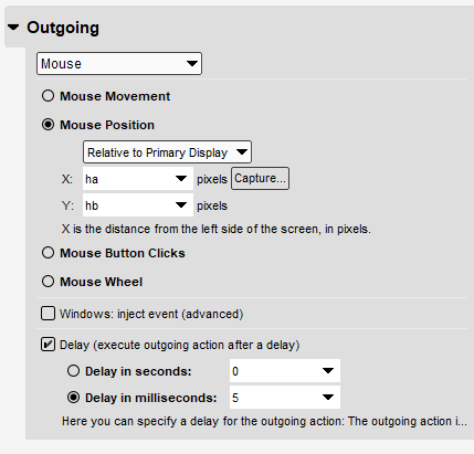

This is the return translator that tells the mouse to return to that position.
For some reason ha and hb are stuck with fixed coordinates.
Return
Everything is the same as before.

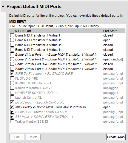

Do you have your MIDIBuddy incoming port set as BMT2? That is where it looks like mouse position commands are coming in? Check settings in MIDI Buddy for incoming MIDI and also for MT Pro to make sure they match. You should be able to monitor rule “ga=” or “gb=” in the filter of your log window to see if they are properly changing as you move the mouse.
Sorry, this is probably something simple that I’m just not seeing.
I have the project level input ports set like this:
Project Ports
The preset level ports are sometimes different, but I tried enabling the MIDI Buddy alias on the active preset, but that didn’t do it.

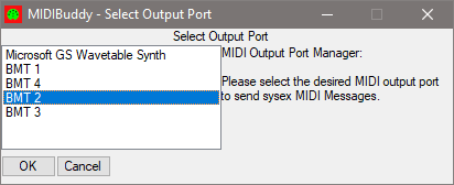

MB is set to BMT 2 now. It was sitting on BMT 3 when I checked. Changed to 2 but that didn’t do it.

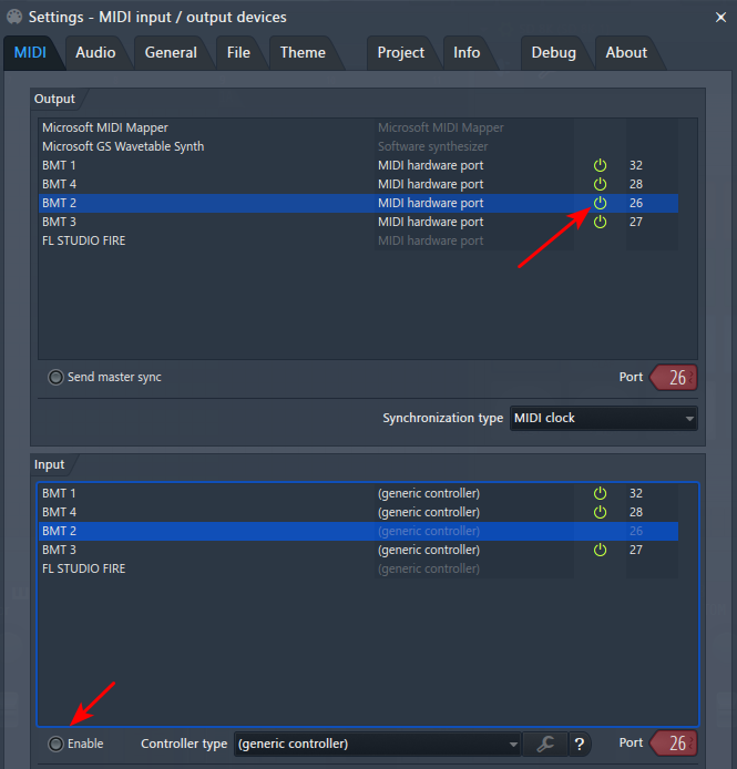

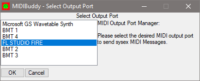

Oddly when I have the Akai Fire device running, that’s when it prompts me that the ports have changed. The Fire is what seems to be stealing the port; I thought it was FL Studio.
Port Position
Fire Steals Port
In the FLS settings the BMT 2 input port is disabled, but FLS keeps opening the output port every time I disable it. I can’t make FLS forget or disregard any ports. I’ve requested that function in the past.

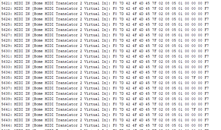

The only log window filter that gives me any activity is the ‘MIDI IN’ one. It gives me raw data; don’t know what to make of it. I got five thousand entries in a matter of seconds.

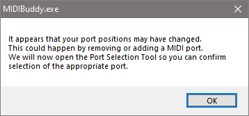

Any time you add or remove a MIDI controller you will get this message from MIDIBuddy about port change. Simply re-select the correct port and it you should be back on your way.
If you remove the port number (set it to blank) then it will not try to open the port.
These are mouse relative movement messages from MDIBuddy. Most of the time you can just ignore these messages and just use absolute positioning messages. The format of these messages is shown in the MIDIBuddy Readme file under the heading ‘Mouse Actions (Unique for each attached mouse)’.

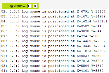

Finally, you can test if MIDIBuddy mouse position and click messages are working with the below project file. Just filter on “Log” in the MT Pro Log window and move or click your mouse. You must select the proper input port for your MIDIBuddy alias.
MIDIBuddy-Mouse-Test-2023-01-16.bmtp (1.5 KB)
Ok, the log tells me mouse movements are working. I put that preset in my project too and is also working. The x and y coordinates are strange, but still works.
Working

Went through my whole project looking for ha hb ga gb. They are only found in the mouse click rules and nowhere else.
The ha=ga hb=gb.
Otherwise it’s all found in the INIT preset.

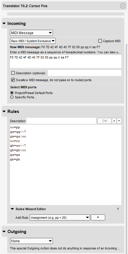

70.2 Cursor Pos mentions these variables a bunch of times.

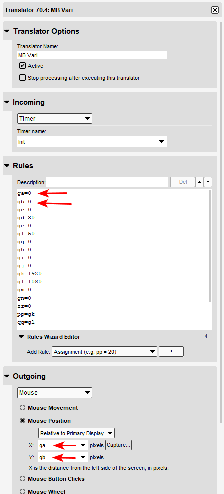

And 70.4 MB Vari (MIDI Buddy Variables)

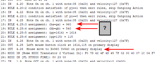

The first time it clicked on the target then sent the mouse to the top left. x 0 y 0.
Then on the second attempt, it clicked on the target then it went back to the same position as before. I was able to capture the location with mofiki’s coordinate finder.
It goes to x 960 y 540 every time. But I don’t see where those coordinates are in my project.
If I use the same mouse click translators from other places, say my keyboard for example, it goes to the exact same location.
The coordinates that you return to will be the mouse position your mouse is at when you pushed but button. You will not find them in your project file as they are derived from the actual mouse position.

Somewhere along the line you got rid of the mouse positioning commands from MIDI Buddy for ga and gb back into MT Pro. This is essential for tracking MIDIBuddy mouse position. I added them back into translator 73.0

My fix I described was a workaround. The root cause I believe was that you disabled preset Init (69.1) after 4 seconds and there are translators within that preset that monitor MIDI buddy mouse movements. Without the preset enabled, you were not receiving updates to global variables ga and gb.
