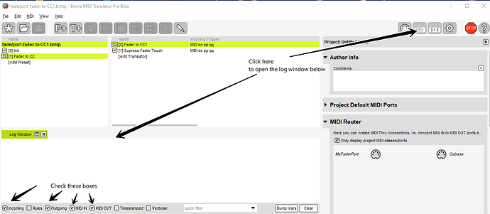

Yes, make sure also that you have input on your Cubase set to look at “BMT 1”.

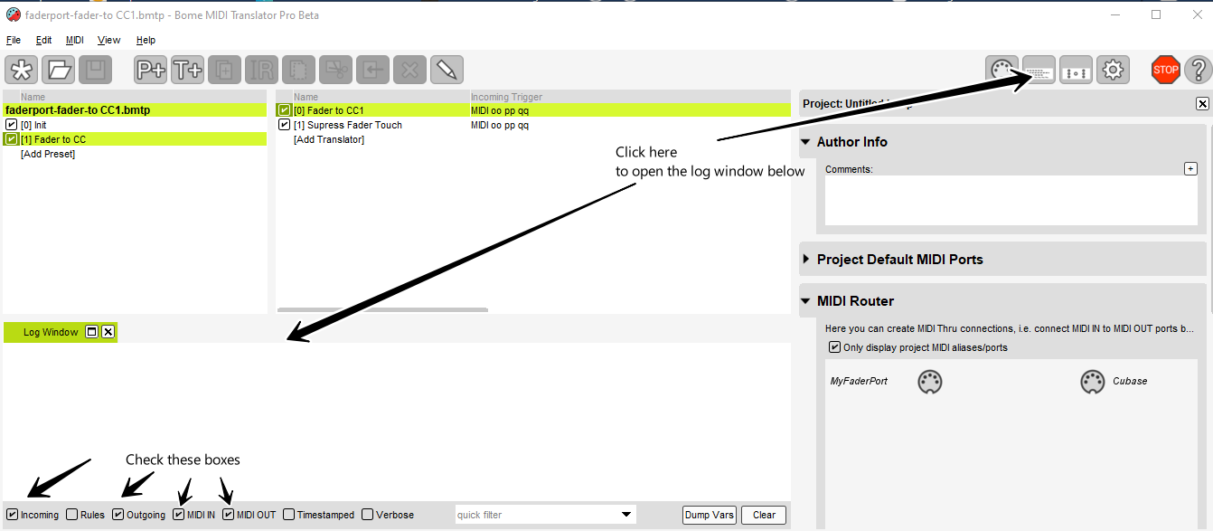

If you want to see what MIDI is going it, it is better to use the log rather than the MIDI monitor. Then check Incoming, Outgoing, MIDI IN and MIDI OUT.
Then move your fader and capture what you see.
Then copy and paste what you see so we can figure out what is going on.
If you don’t see any incoming message that means that perhaps Cubase is holding your FaderPort MIDI port open so make sure it is de-selected for input in Cubase and select “BMT 1” instead.

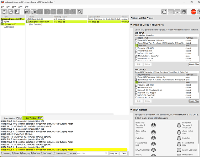

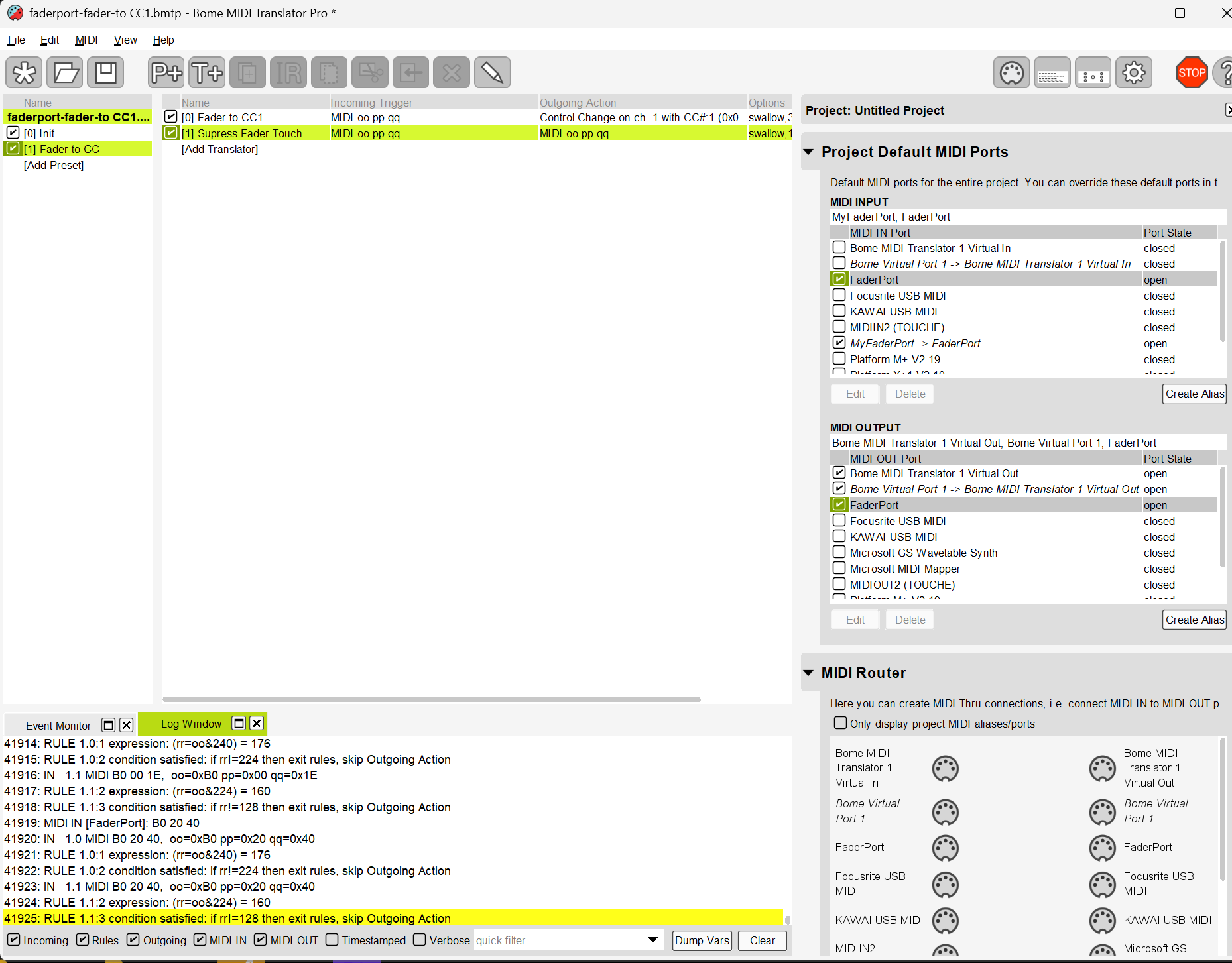

There is no midi out comming from the script. For midi in i got this:
Your fader is sending B0 20 40 which is not a Mackie MCU fader message? You must have put the Faderport into MIDI MODE (instead of Mackie MCU mode). Please set it to Mackie Mode.

Could you post a snapshot of your Bome MIDI Translator Pro log window with MIDI IN and MIDI OUT selected?
It works now. This is so great thank you.
