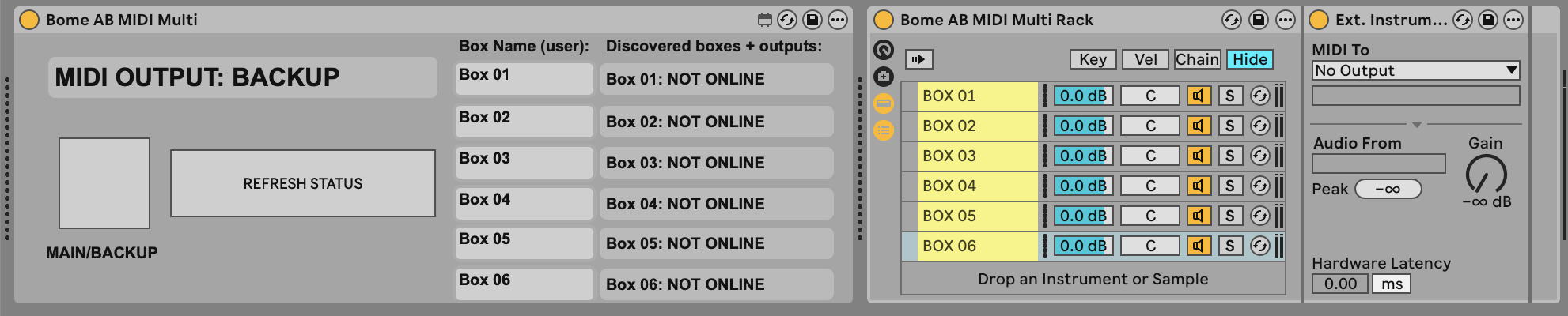

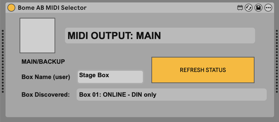

I’ve been working through a solution for when using multiple Bome Boxes on stage to send PC, CC and clock etc from a redundant Ableton playback system to switch keys patches, guitar moddeling boxes and so on where as only one computer would be sending the MIDI from Ableton at a time instead of both, (useful for Clock and PC messages in my experience.) My aim was to have visual feedback to view the ‘state’ of the translator whether its sending MIDI outputs from the Main or Backup computer and to MIDI map a toggle button so that I can quickly change this state with my MIDI controller at the playback rack.
I’ve come up with a set of translators for the Bome Boxes and some Max For Live MIDI devices for Ableton. The Max For Live devices can monitor and detect each Bome Box running the translators (up to 6) and toggle the state between MIDI being sent with a MIDI mappable button.
I have tested the system but wondering if anyone else would like to test it to make sure it runs as expected, as my knowledge of Bome Translator Pro is not massive.
