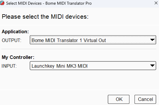

I used aliases in this example as follows:
You will need to assign them to your desired physical MIDI ports. You will be prompted when opening the project.

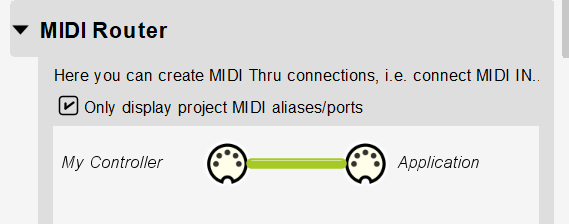

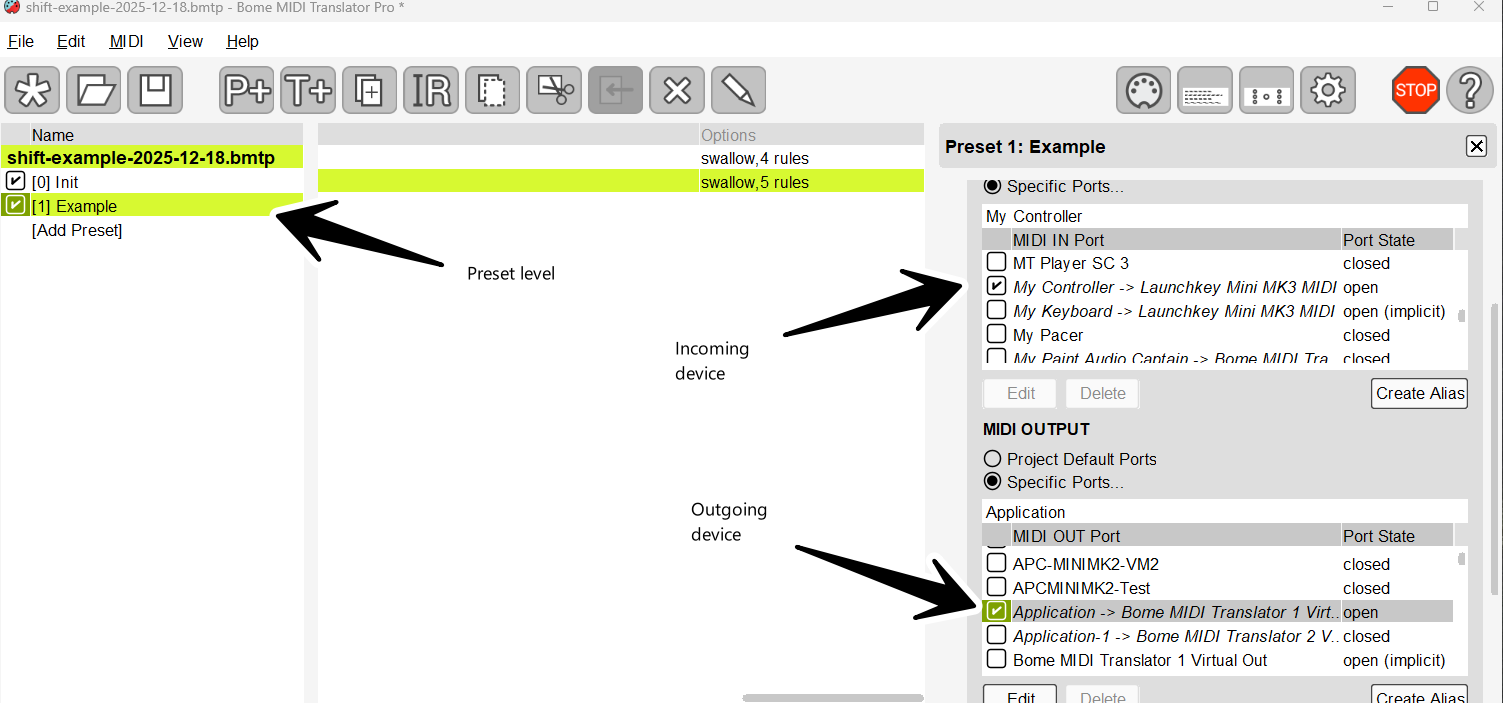

I set up translator routing at the preset level.
Anything not handled by a translator is passed through untouched using the Bome MIDI translator Pro MIDI router.
shift-example-2025-12-18.bmtp (3.0 KB)
