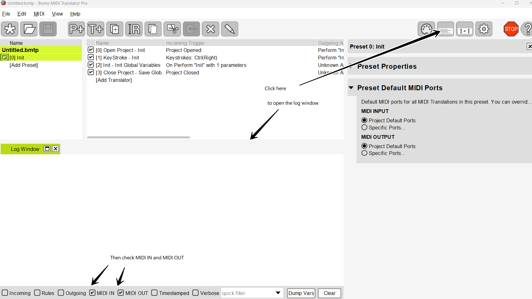

Can you turn on the log Window and then check MIDI IN and MIDI OUT and show me what MIDI message it is sending? What control in Ableton Live are you trying to control with the footswitch? We might need to add a translator to give Ableton Live something it can use.

Here is what the log says when I hit the appropriate footswitch:
