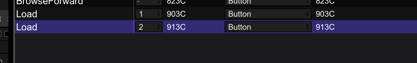

Hi Steve, first thanks for taking the time and you surely don’t have to apologies to me. It’s hard sometimes to describe things when we’re not too technical (speaking about myself) but here I am explaining what I mean by “Forced to change channel” and also try to clarify exactly what’s my issue.
I would like to also make you aware that I’ve not purchased a full PRO license and I really hope this would be worth it.
In regards to being “Forced to change channel”…
As you can see from the 2 first shots… first is for Loading Left button (for DECK 1) and then same for Right Loading button for DECK 2
[Figure 1]
[Figure 1]
Where the arrow is, is where I have to change channel… otherwise Rekordbox will pick the midi signal as THE SAME… (both deck 1 or both deck 2) Check [Figure 3]
[Figure 3]
But by changing channel (wethere it’s the right or the wrong thing to do) IT HAS WORKED.
I managed to get every functions I wanted… the final part to wrap this up… is CUE points… On the unit I have 5 in each side.
I have selected one single input midi signal on each (as there are couple since it’s a PRESS and DEPRESS) I managed to get 6 working but then I runout of channels so it is now picking the remaining press as similar to other on the learning process… Check [Figure 4]
[Figure 4]
I’m baffled because all these are different buttons, I have no clue why are they being interpreted to be the same… it’s like the MIDI OUT SIGNAL IS ALWAYS THE SAME and they are battling which is going to take that function I’m targeting…
I hope this makes sense… if not I can follow up with signal log output… but I thought this should be enough to guide you. If not pardon me and I’ll follow up with more logs.
