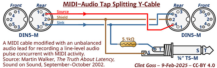

I have built a set of specialized MIDI + Audio Y-cables that have MIDI-In, MIDI-Out, and an unbalanced (TS) Audio Out. Pretty simple - a could of resistors if I recall - and I get a sharp audio pulse when the MIDI passes through.
What I could do, I guess, is to take the output of my 4 paths and send them to 4 MIDI outputs rather than into Surge. Then use my cables to record the Audio pulses in Reaper. The issue with this may be that the MIDI gets serialized in the output MIDI interface, affecting the test. The MIDI may also be getting serialized on the input side … another issue … Ugh.

PS: I’m using a similar DIY setup for latency measurements. But you may risk your soundcard if you feed the 5V MIDI signal directly to a line input. Scaling it down to 1V with resistors is a good idea…

risk your soundcard
Here’s my ‘Audio Tap Cable’ config … I built several of these in 2022 for this kind of testing …
