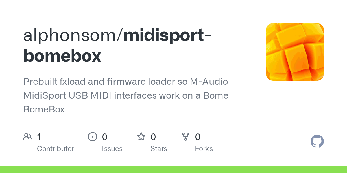

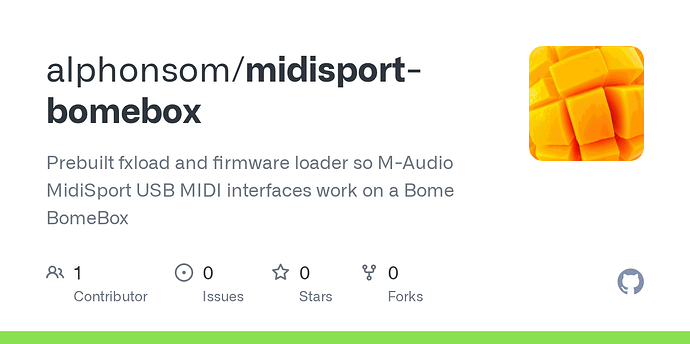

There is now a firmware loader for BomeBox to enable Midisport devices. It can be got at
You have to use scp to copy the files to the BomeBox and then (if ssh is enabled) ssh to start a shell to run the installer. I have only tested it on a solitary device, a M-Audio branded Midisport 4x4, so no guarantees.
