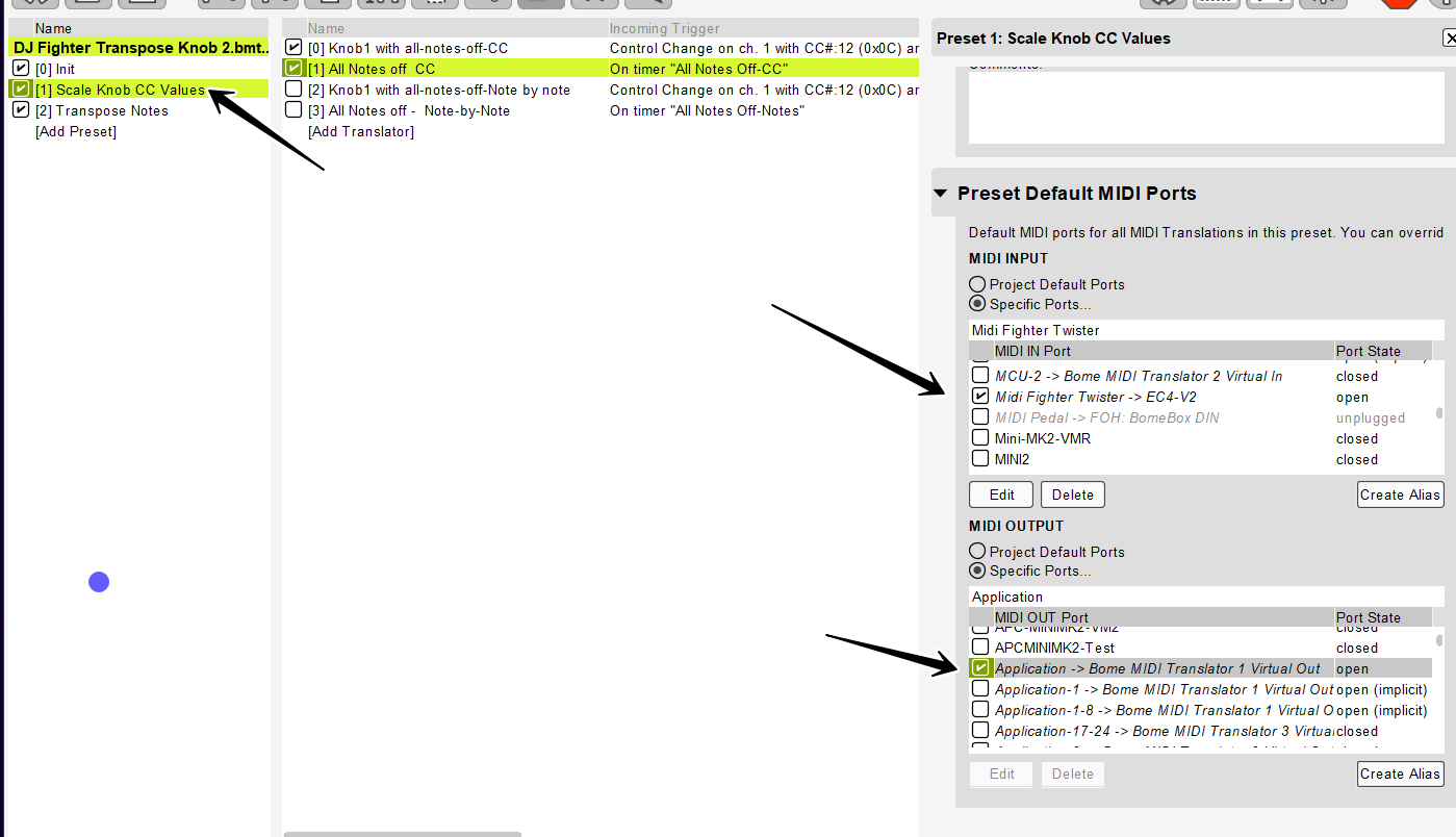

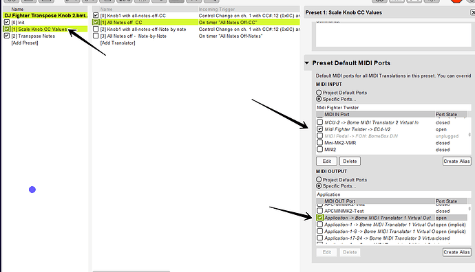

First I use aliases instead of physical ports. It will make it much easier later if you want to use different ports.
Here is how my aliases are set up.

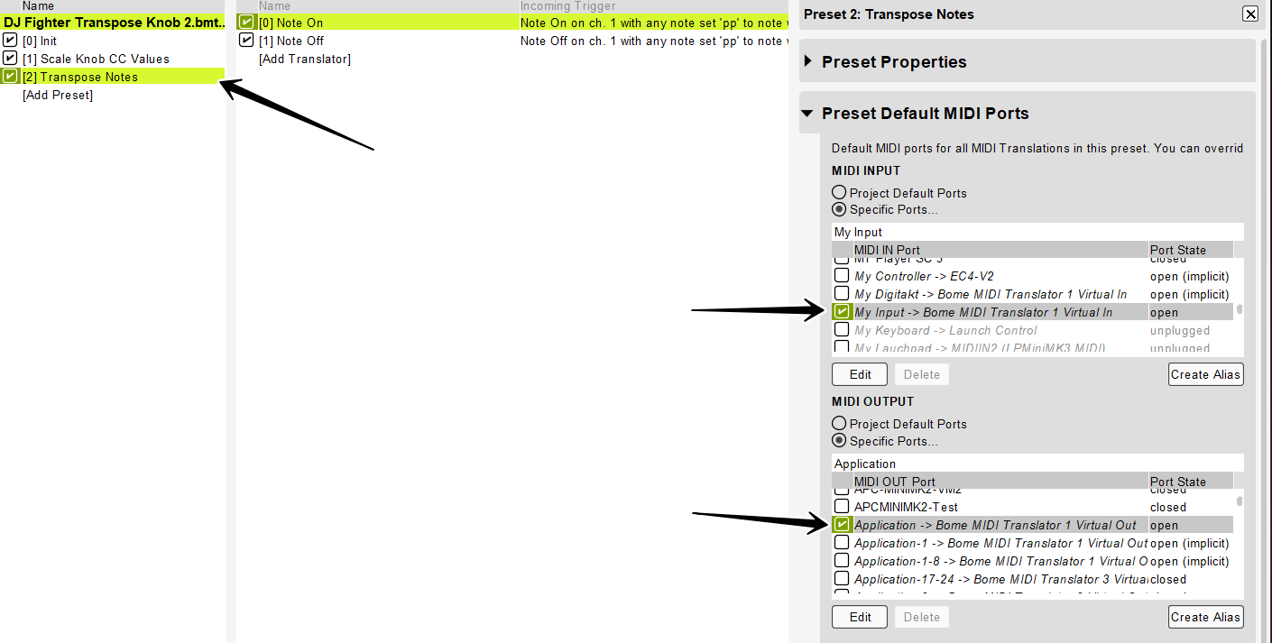

Then I set up device selection at the preset level.
Preset 1 is set as follows:
And Preset 2 is set as follows:
