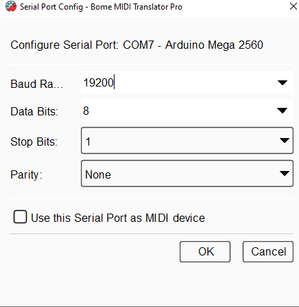

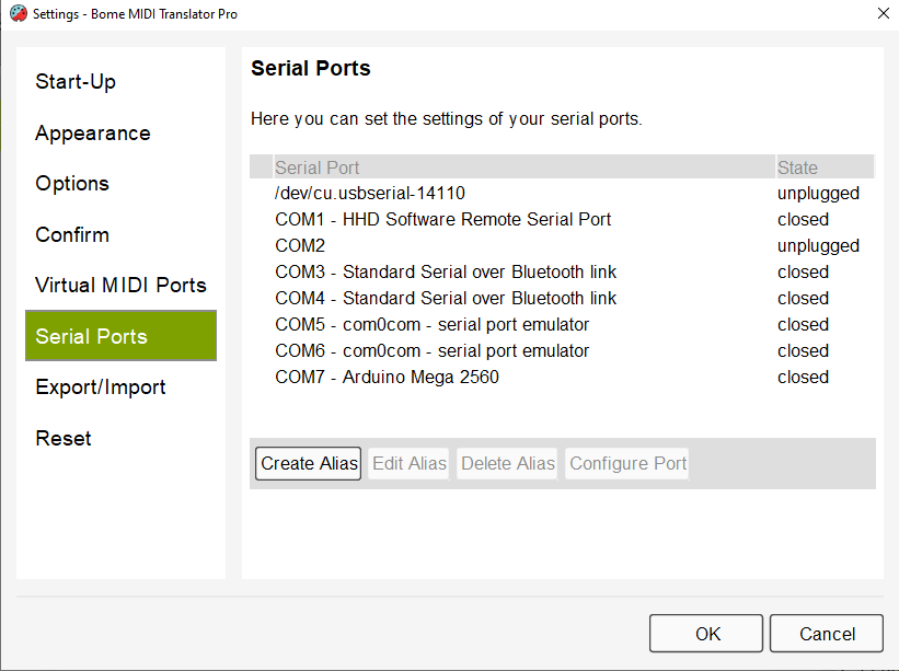

There is a setting that you would need to set to define the port and baud rate that you want to used.
You click the desired port and then “Configure Port” to change the baud rate etc.
That works, thanks! Always a relief when I don’t need to rely on another software.
