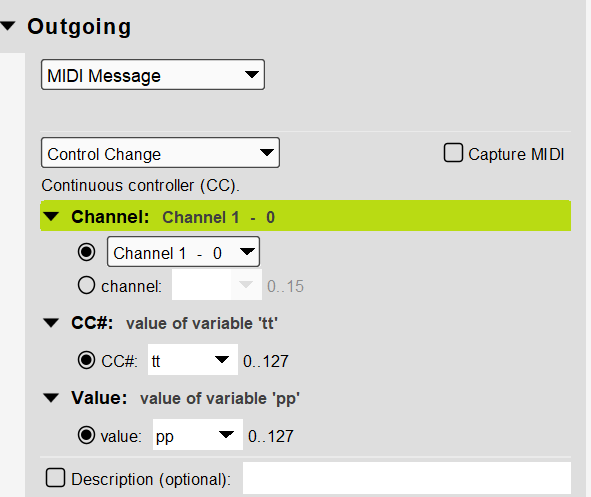

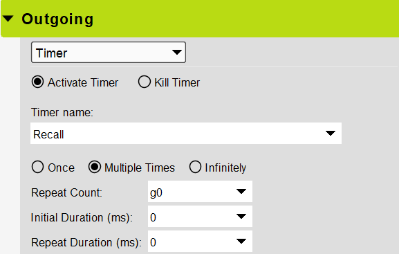

Here is the timer version.’
I disabled translator 1.8
The recall is called by translator 1.9 which starts at timer setting g0 to 8 and decrementing it on each count. We call the timer 8 (g0) times
Translator 1.9 rules determine which varible value to send. Here are the rules.
// decrement the counter (going higest to lowest)
g0=g0-1
// adjust outgoing cc number and put into the local
// variable tt
tt=g0+21
// put the stored global variable into the local
// variable pp
if g0==0 then pp=ga
if g0==1 then pp=gb
if g0==2 then pp=gc
if g0==3 then pp=gd
if g0==4 then pp=ge
if g0==5 then pp=gf
if g0==6 then pp=gg
if g0==7 then pp=gh
Then we send the value of pp (pulled from the appropriate global variable) one at a time.
