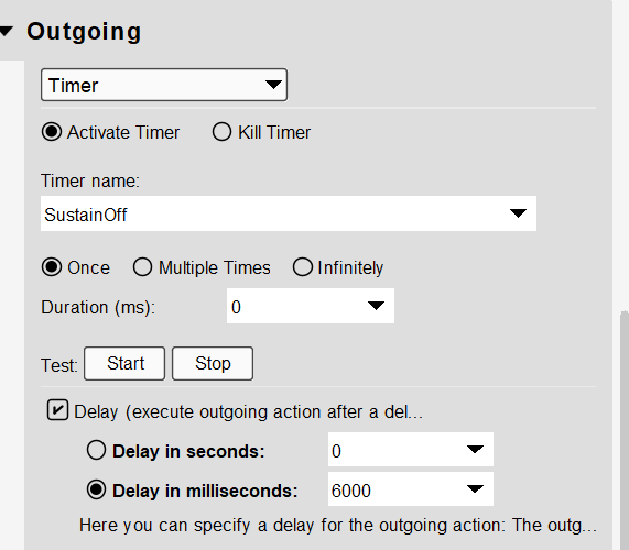

Hi, you have the delay in the wrong place. You are delaying the outgoing action for 6 seconds instead of setting the timer for 6 second.
Here is what you have:

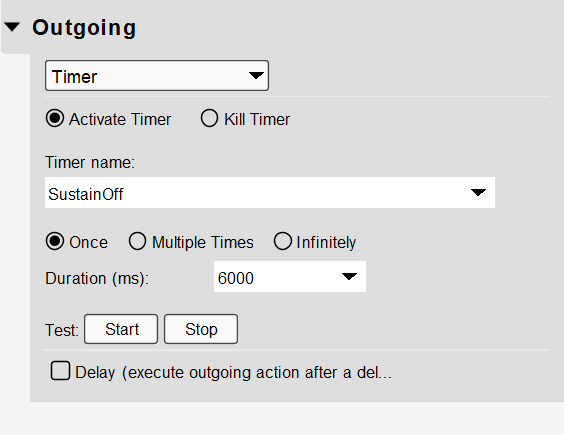

and what it should be
The first field is for the timer delay and the second field is for delaying the outgoing action.
