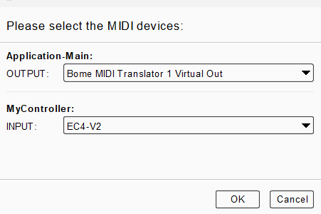

Please find the attached. In rules, we toggle the value of global variable “ga” and then send the value on each press. In this example, I’m using CC21 on MIDI CH 1 for both input and output
Here are the rules:
// toggle value
ga=ga^1
//defalult value =0
qq=0
// otherwise send 127
if ga==1 then qq=127
My aliases are set up as follows:
toggle-cc-2025-09-19.bmtp (1.1 KB)
