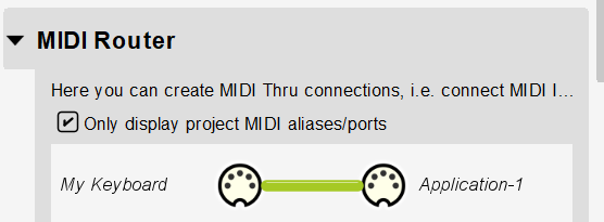

I also set up the MIDI router so that all other MIDI messages will pass through untouched.
I set up my aliases a follows. You will need to change them according to your physical MIDI devices.
