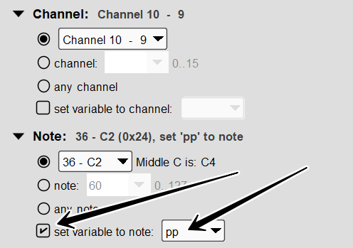

Having trouble sleeping. Got up to play with the program. Made a slight revision to the outgoing preset selection, from # to name, and while doing so noticed that the program works…beautifully, but only so long as MIDI capture is turned on! Does that possibly mean that I need to use an incoming MIDI raw message instead of Note On?
First of all you don’t need the rule in the translators in preset 1 since you have already defined the incoming note. Example below is 1.0
if pp!=36 then exit rules, skip Outgoing Action
However if for some reason you want to use it you need to set these on your incoming trigger to assign incoming note to the local variable pp.
I would just recommend either removing or commenting out the rule.
You implementation actually looks very clean. Good job!
Well sir,
I suspected it might have something to do with a mishandled variable. I’m pleasantly surprised that it was such a simple fix. Variables assigned and rules removed, per your suggestion. Program is working flawlessly! I’m grateful that you are there and were willing to give me so much help. I’m telling you, my girls are really excited to begin their lessons…and you are hugely responsible for making it happen. I/we owe you big time!
