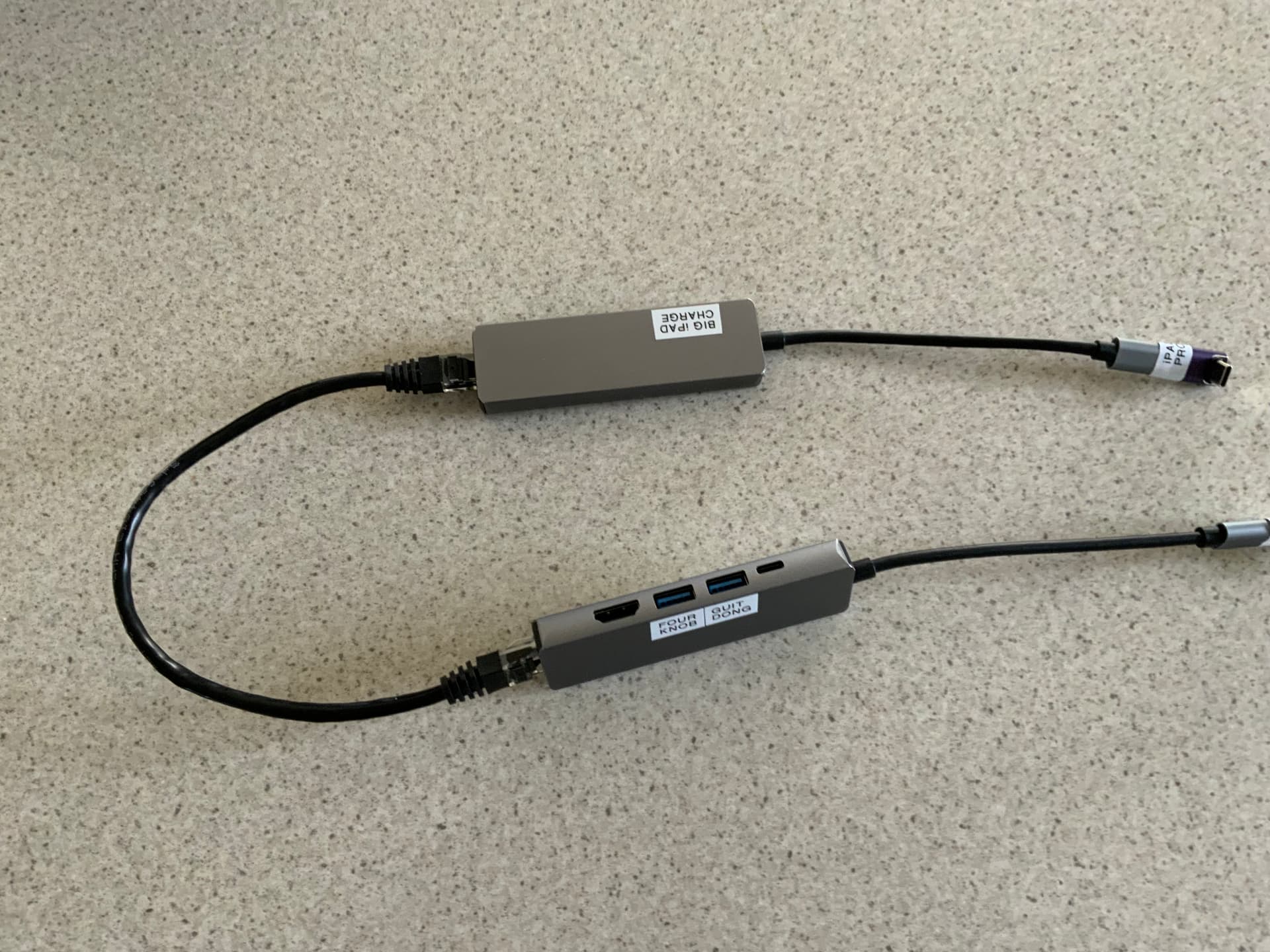

Another morning of mostly experimenting testing adapters and cables etc. I finally have a working Ethernet connection that is reliable so far.
After declaring that all my spare adapters would not connect, I decided to hook up two adapters as shown above with a short Ethernet cable. I connected one adapter to the iPad and the other to the thunderbolt port on the PC. I bypassed the powered Ethernet port in the powered hub and I’ve had good steady connections since.. I will keep testing for a day or two to make sure the connection is robust and continues to work.
