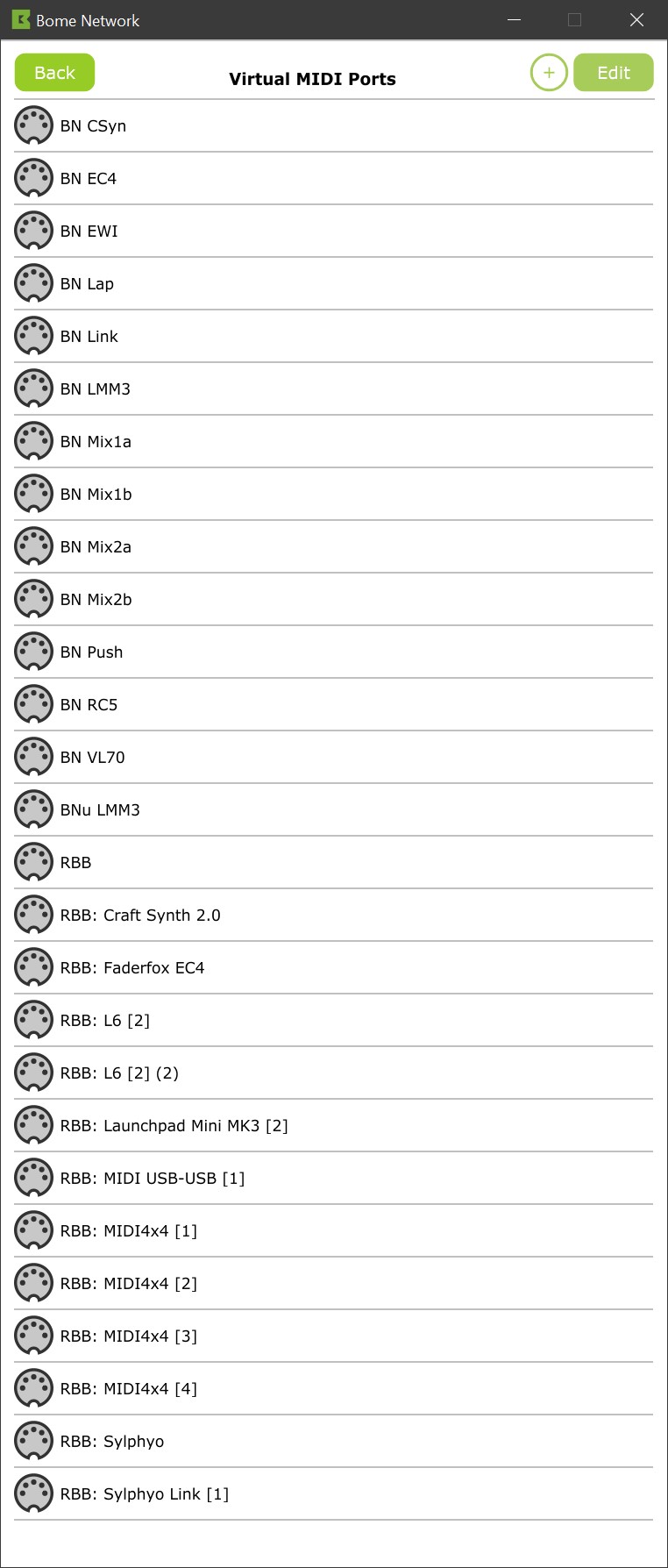

Here’s my Bome Network Virtual MIDI Ports:

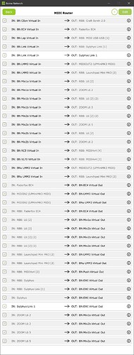

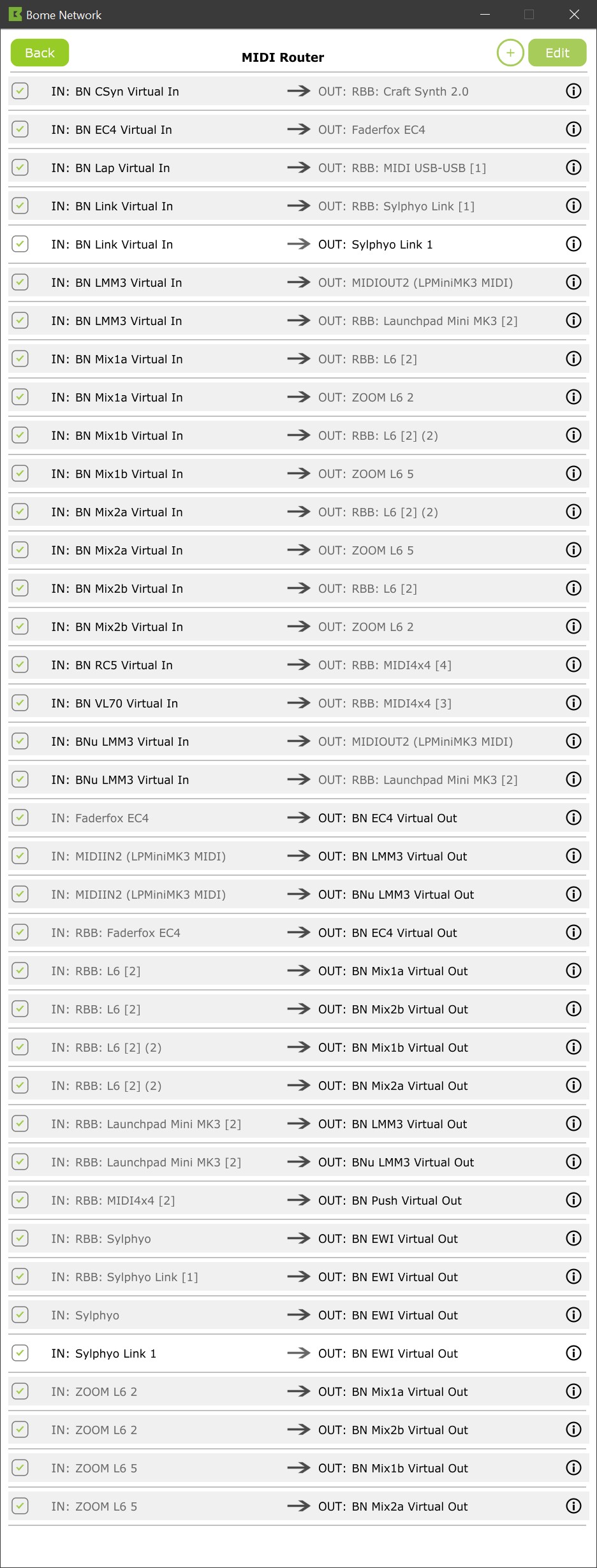

… and here are my Router paths (my rig is powered down right now, so most are not active):

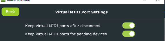

In Bome Network settings, turn these switches on (under virtual port settings), and see if it helps. I suspect that Windows is getting burdened with adding and removing virtual ports which may be causing some problems. With these settings the virtual ports will always be their whether connected or not, otherwise I believe Windows removes them when they are not there. You have a bunch of them so this may take time to recreate them when they are available again.
No Joy. BMT still crashes whether I have Processing On or Off.
The second option of the two you show was already enabled in my system. The first option was disabled. I enabled it on for these tests and will leave it on.
