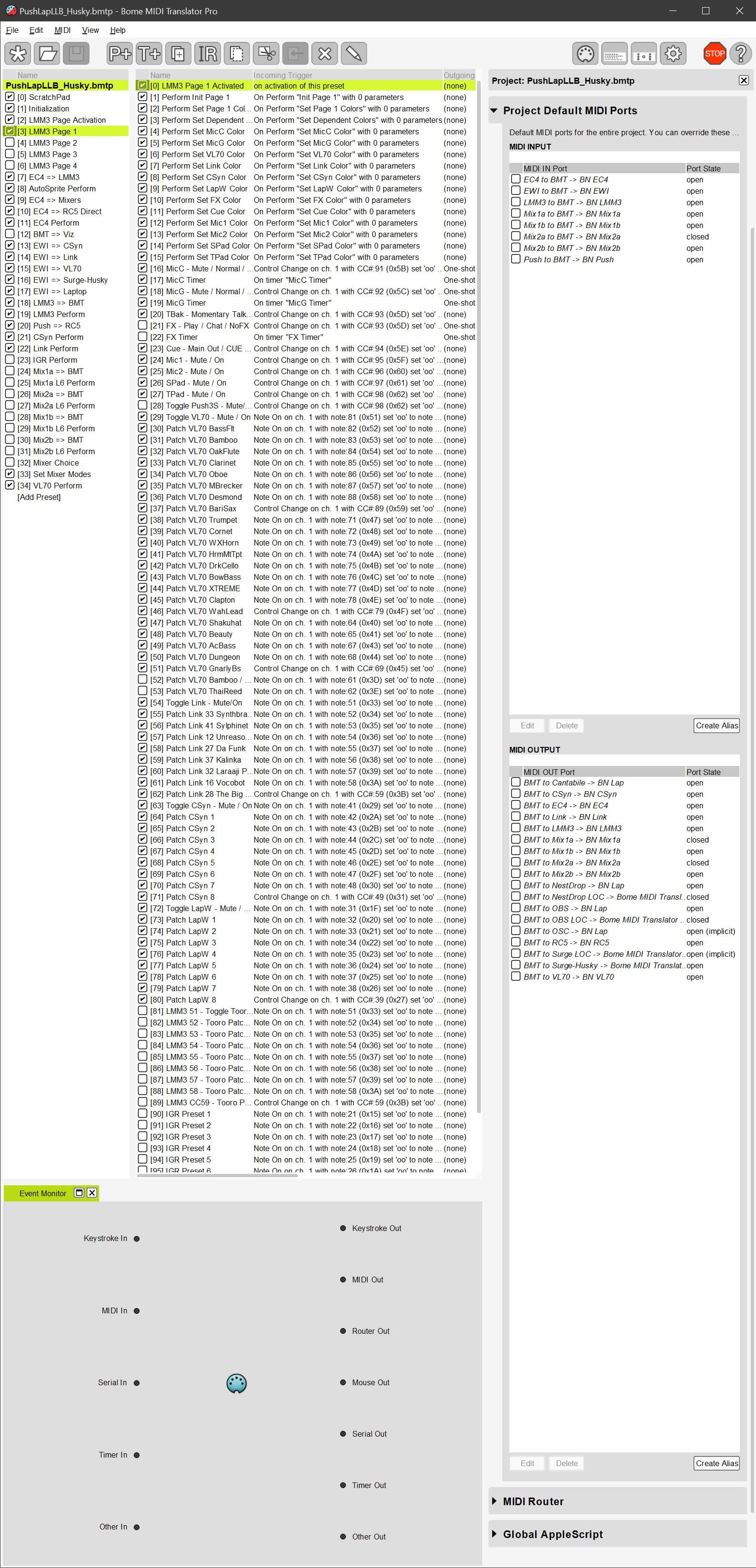

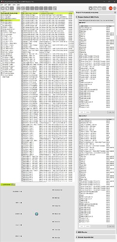

Before import, my project MIDI ports looked like this:
… lots of ports … After the import, it looks like this:
Is there a reason for this that I am missing?

In the first screenshot, notice that I have a LOT of Project MIDI Ports prior to the import (notice the slider to the right of both the input and output ports). After import, I seem to only have those that are in use.

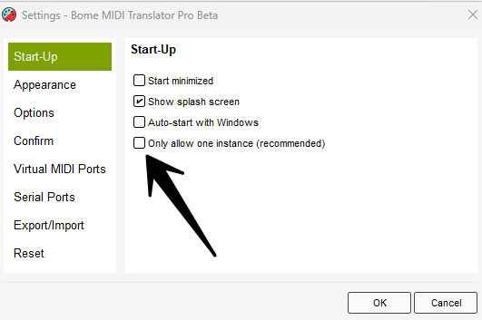

Are you running more than one instance of Bome MIDI Translator Pro ? Do you have this checked?
For when you get back, maybe you should use the suggestion. on page 105 of the manual. Especially if you are going to run multiple instances of Bome MIDI Translator Pro. It talks about create different executables under different names of Bome MIDI Translator Pro , each which use their own settings file.

I have had that [Only allow one instance] option turned OFF in the past, in order to do copy-paste of presets. However, that option is now ON and only one instance of BMT has been running in all the tests over the past few days (confirmed by the Task Manager) …

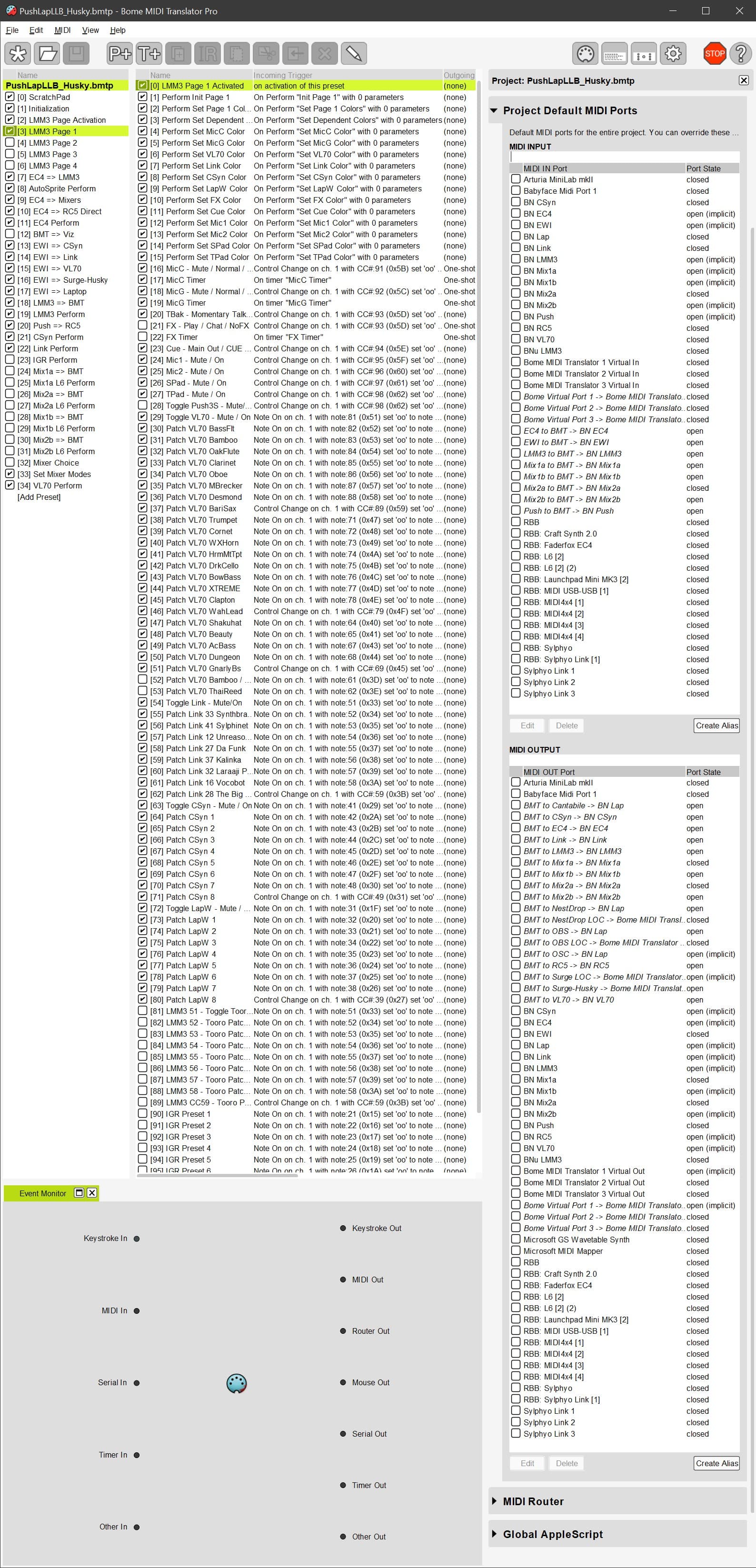

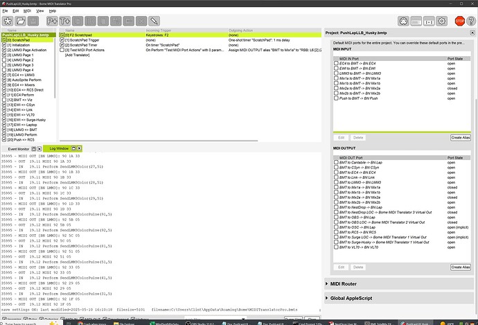

On the other issue of the effect of a settings import … here is a snapshot of my Project Default MIDI Ports before a settings import:

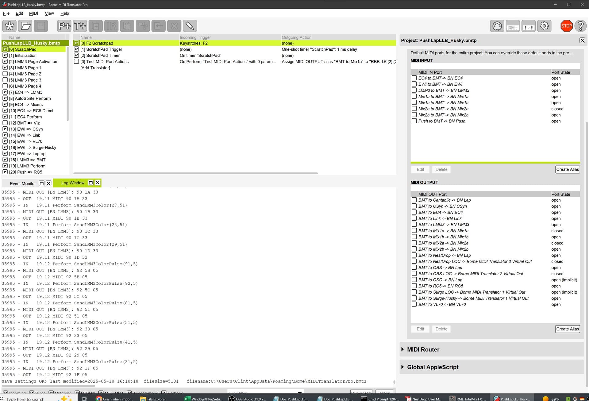

… and immediately after importing the settings file I had just exported:
So the [Import] seems to leave me with only the Aliases showing. No closed MIDI ports are shown. This makes it difficult to change alias mappings. The cure is to re-launch BMT and all the closed ports re-appear.
