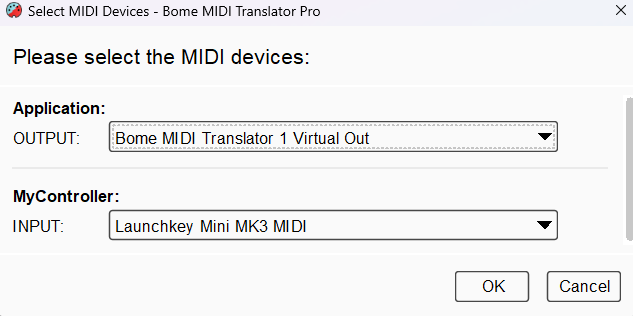

Here is how my aliases are set up. You will need to set up for your actual devices.
