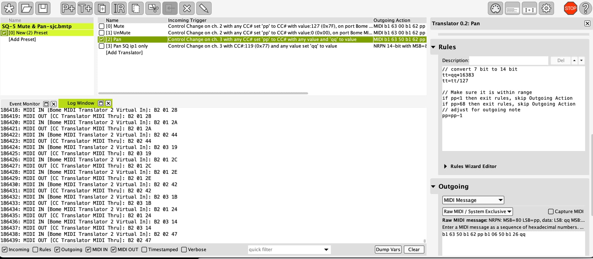

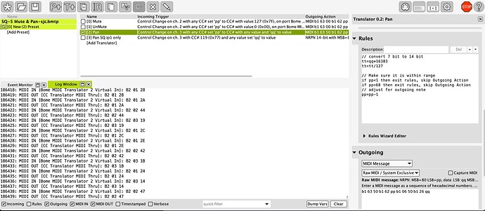

Hi, the log shows the MIDI Message coming from Bome MIDI Translator 1 Virtual Port In? Try either changing it to Bome MIDI Translator 2 Virtual Port In or set translator 0.2 to look at Bome MIDI Translator 1 Virtual Port In.
Hint, if you have both Incoming and MIDI In checked and show only MIDI In, then that meants either the message is wrong or coming from a port that is not selected as input.

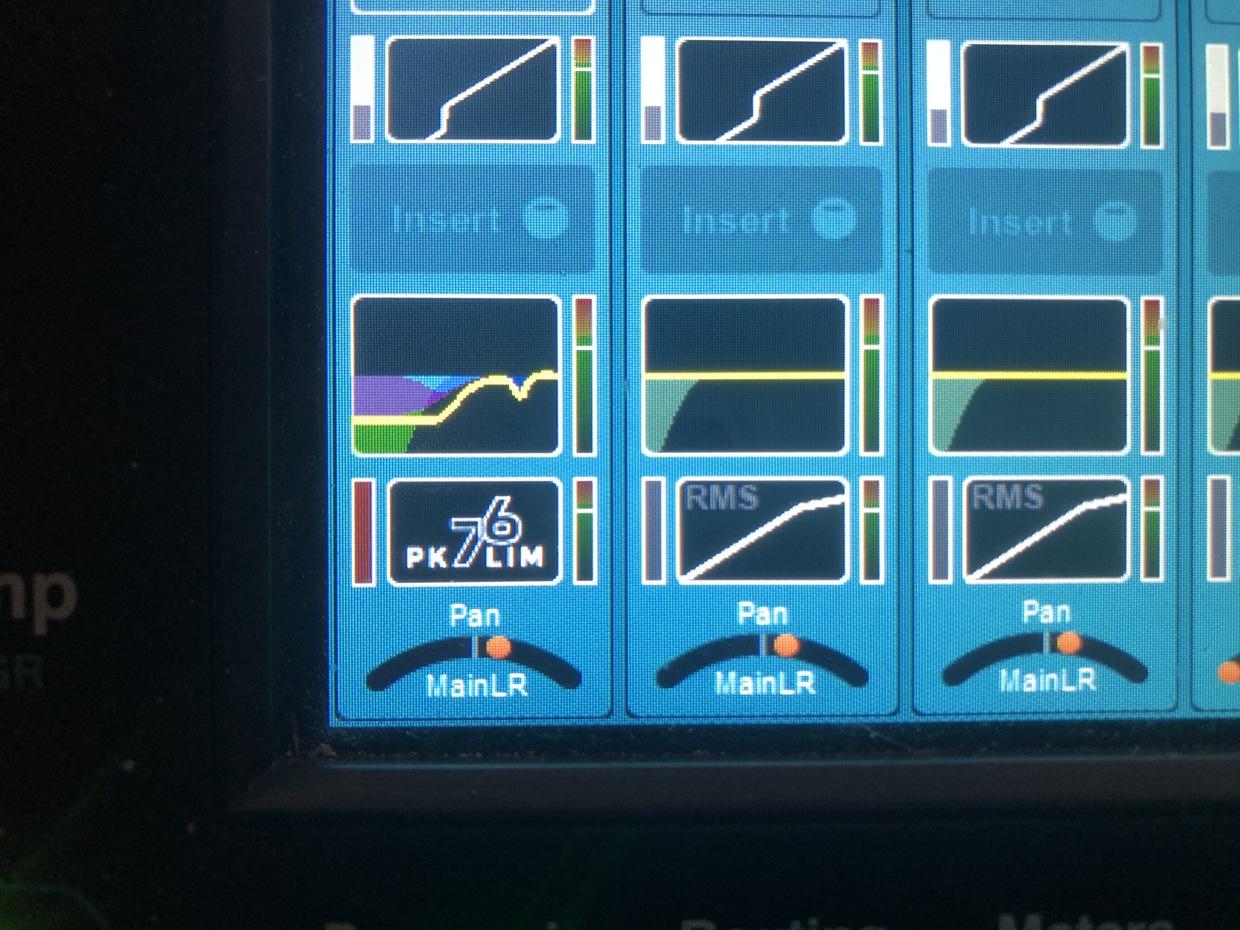

When Logic plays, the three SQ pans don’t follow the programmed automation but all three freeze at a position with a value of approximately 80
Yes, because the translators are not working because you are sending MIDI to the wrong MIDI port. See my previous explanation.
but now ‘Bome MIDI Translator 2 Virtual In”
that’s good, right?
Yes that should work
