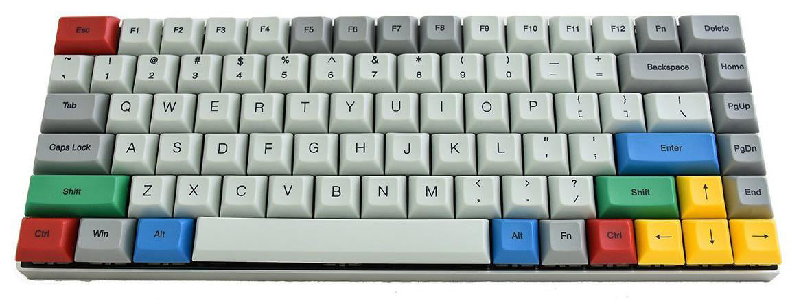

My goal is to create a qwerty 5 row CBA (chromatic button accordion) System-C midi accordion.
I’ve gotten pretty far with the right hand. I found a great mechanical qwerty keyboard that has pretty consistent isomorphic button placement. (a lot of times the F1-F12 keys break the pattern)
This mechanical keyboard also allows any key to be reassigned to any other key (as long as it’s already on the board) This allowed me to reroute some tricky keys like the left shift to be recognized as a separate button in order to extend the range of the ‘instrument’. It’s also NKRO meaning it can play full ‘polyphony’ unlike most membrane qwerty keyboards which typically have 4KRO or 6KRO and usually have weird combinations that aren’t playable (due to how membrane keyboards are wired).
It’s working great for just the right hand with midi translate pro running on my laptop. I’m going to add a separate octave switch (maybe just using a separate little pitch bend module or two other keys). Midi Bome actually creates a very flexible environment to add expression controllers combining 2 or 3 different usb inputs results in a pretty expressive instrument.

Ok, now that I’ve done this the wrong clunky way.. I’m ready to do it the smart way. Here’s what I did.. I tried to find as many unique characters as possible for example numpad keys are recognized separately F13-20 is recognized. So I remapped all those qwerty keys to a second qwerty keyboard for 2 octaves lower. (it gave me a 6 octave range between the two qwerty keyboards)
It’s actually working.. and it’s reasonably playable..
