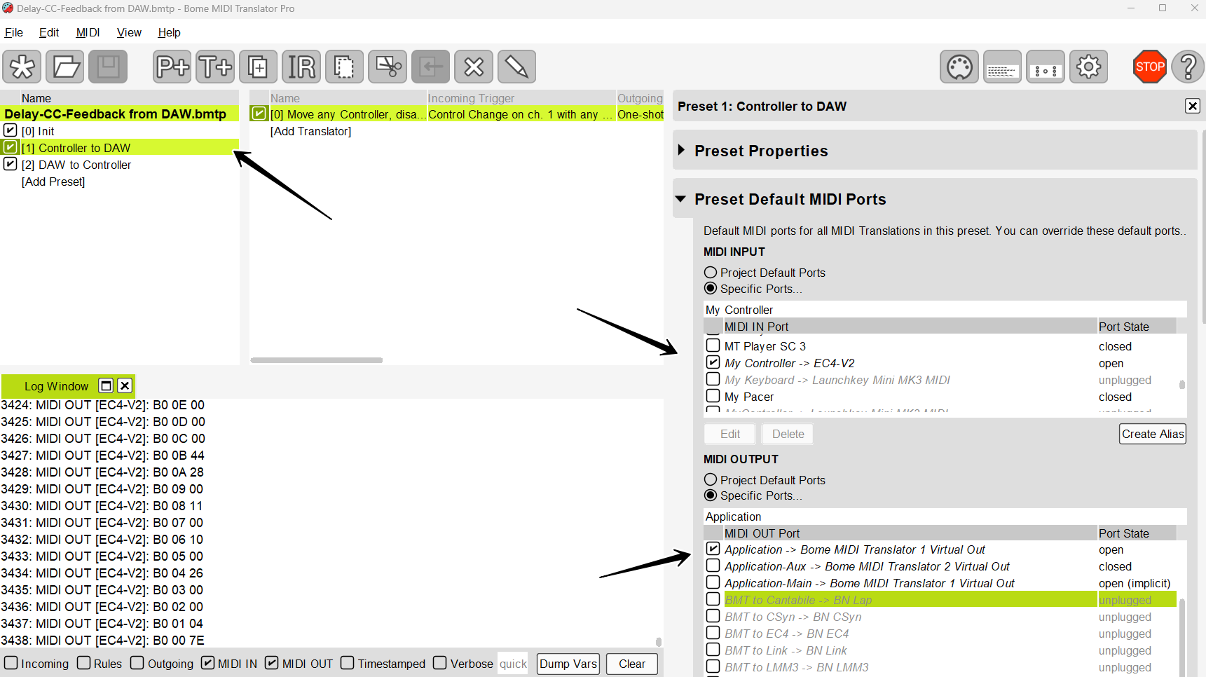

In this example we detect CC values from the controller and if they are within scope of the desired CC’s to delay feedback (in this case 0-19), then we set a one shot watchdog timer to trigger after 250 ms of inactivity (translator 1.0).
We capture MIDI messages coming from the DAW in translator 1.0. Again, if they are in-scope, we capture them in global variables but there is not output (yet).
When you stop moving an in-scope CC and the watchdog timer trips (after 250 ms) we call a refresh timer to send all of the values back to the controller)
The watchdog timer is translator 2.1 and the refresh timer is translator 2.2

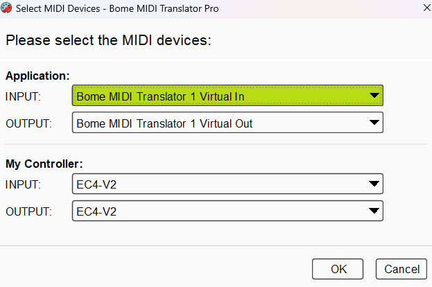

My aliases are setup as follows:

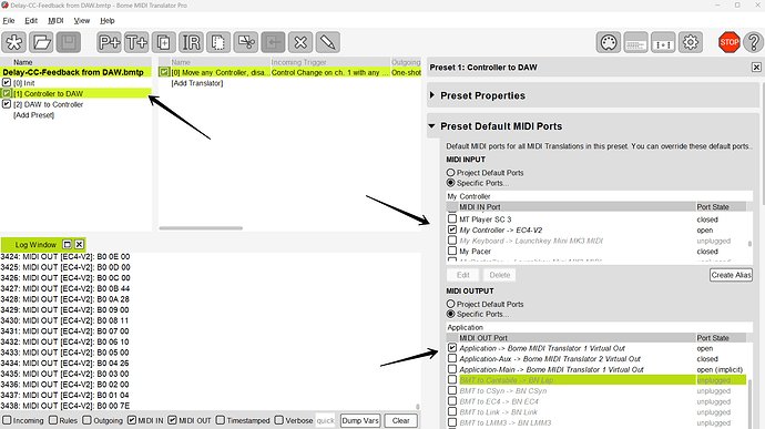

I organize my device selection by preset.
The rules of translators 2.0 and 2.2 determine the global variables for capturing and sending each controller value respectively.
You can adjust the watchdog delay in translator 1.0 and the delay of iteration between CC’s sent back to the controller in translator 2.1.

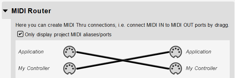

Finally MIDI thru paths are in place for any other MIDI messages and out-of-scope CC messages.
