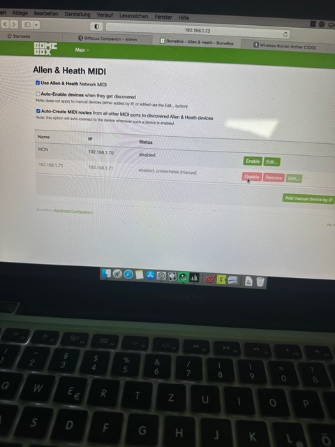

I did a factory reset and tried to connect the surface manually but it says ‘enabled, unreachable (manual)’ and doesn’t do any connection. I can see it in the director app and ping it but bomebox can’t connect to it. Is there any update to the V2 Midi Implementation already?
Could I see a screenshot of your BomeBox A&H web page and also a screenshot of how it is connected (network connections) with dLive director?

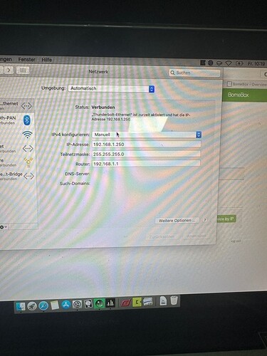

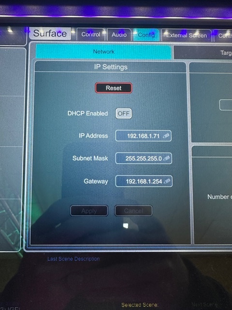

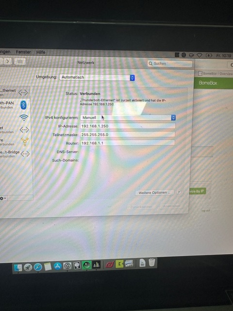

Could I see a screenshot of your BomeBox A&H web page and also a screenshot of how it is connected (network connections) within the Surface?

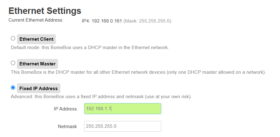

Set up BomeBox ethernet as follows:
Set up your Surface as follows:
Or gateway maybe should be the same as the BomeBox but I don’t think it will matter as long as they are on the same network.
If it doesn’t automatically connect, then manually connect it using
“192.168.1.71:51328”
This ensures both devices are on the same network and you are using the right port.

I set the bomebox to
192.168.1.73
255.255.255.0
it still shows followiing and no connection possible :confused: any ideas?

That’s exactly what I tried!
I disabled the connection to the mixrack, hit manual and put the ip including port as you wrote but it still shows what I sent in the screenshot.
The product Manager of A&H Daniel Lauer said, you might not implement the V2 Midi Version. But I’m not quite sure if that’s the reason we don’t get the connection to the surface.
OK, I’m not sure if the protocol has changed significantly with V2 version. I will see if our developer can get in touch with Daniel. But your screen shot does not show 51328

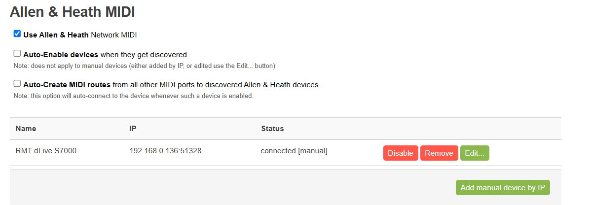

It should look like this however with a different IP address than mine. After adding the IP and port manually I renamed the device by clicking edit and entering the name I want.
Also do not enable auto Create MIDI routes.

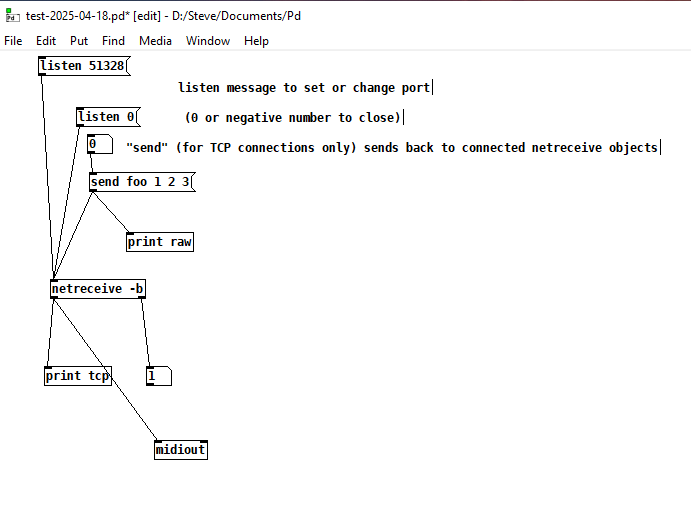

In my case I’m simulating my A&H device using Puredata application on my computer. I don’t have any A&H device in my studio to test with.
Hey Steve,
This made it work!
Thank you very much!
