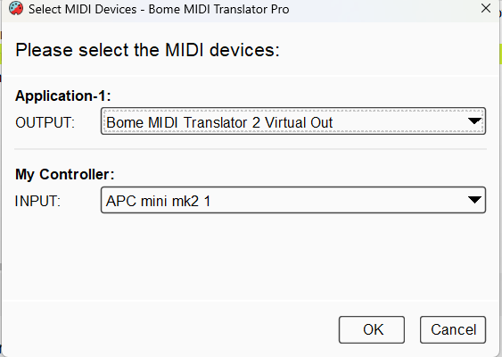

For my example the aliases are set up as follows:
You can change the incoming trigger in translator 1.0.
You can also change the target note numbers in the rules of translator 1.0
You can set the timer delay on the outgoing action in translator 1.0.
