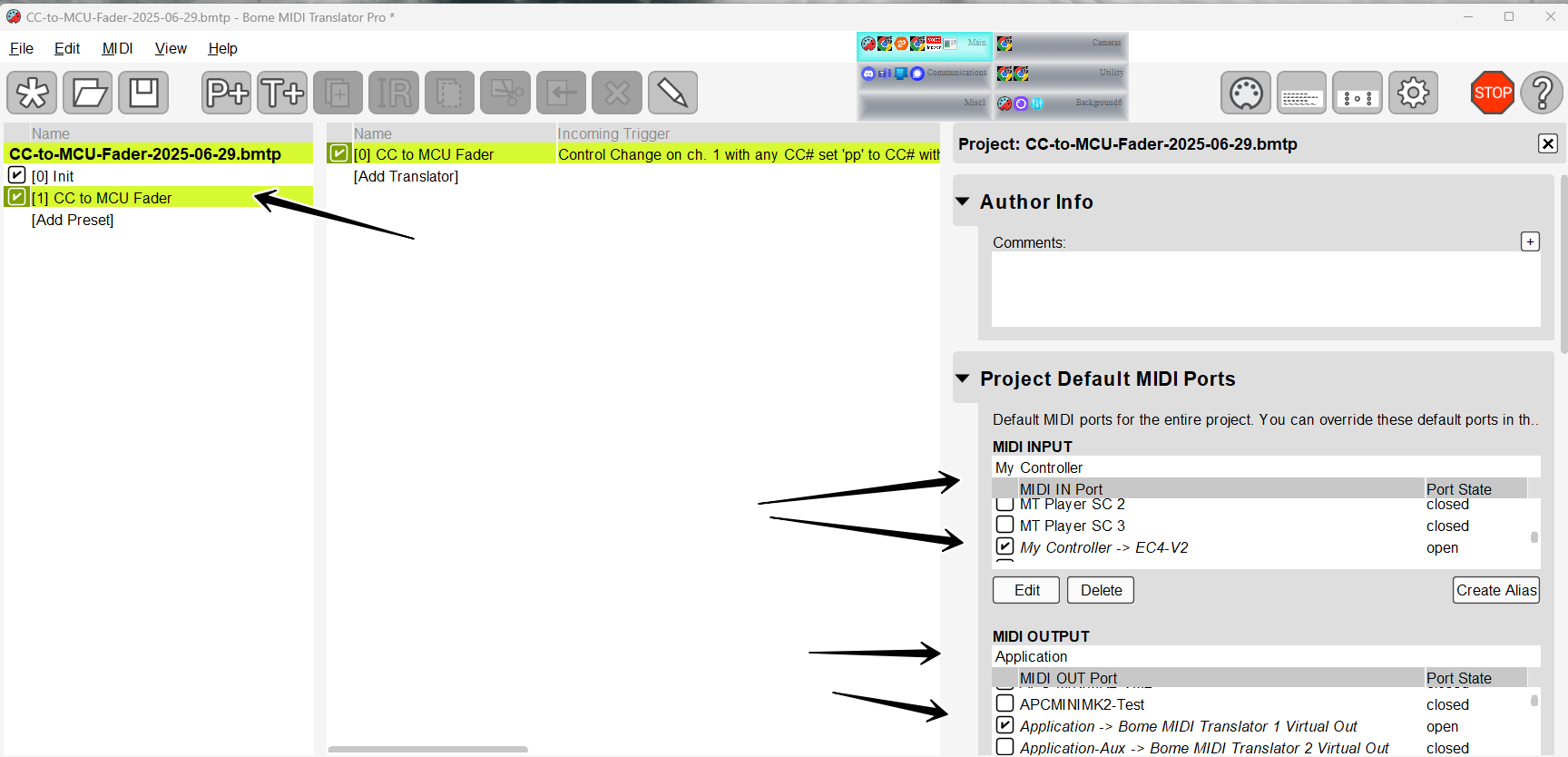

Well, I’m not sure how LUNA focus works but the attached file will convert CC0-CC8 to MCU Faders 1-8 and master fader.

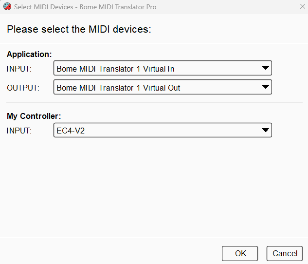

Here is how I have my aliases set up.
I set up my device selection by preset as shown below:
Here is the project file.
CC-to-MCU-Fader-2025-06-29.bmtp (1.8 KB)
Ok this is awesome. Works perfectly! Thank you Steve.
