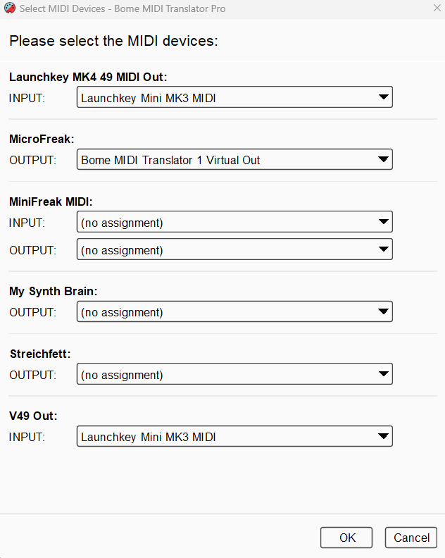

I see you are using the following aliases (although I haven’t assigned them on my system. Which devices do you intend to use and which devices are you elliminating?
Some of the presets have different input devices. You might want to redefine the selected devices for each preset (after assigning aliases). The same is true for output device selection by preset.
I would like to just start fresh and use only the MiniFreak and the Bome Box in this new setup. I’m eliminating the need for an external MIDI keyboard controller for this loop.
The easiest way to start fresh it to elliminate all unnecesary presets and translators. If you still have aliases, you need to remove all references to unused aliases in your project file.
Then start rebuilding any new translators that you want.
