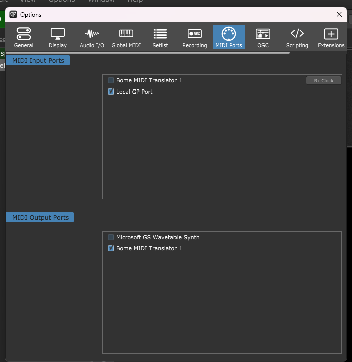

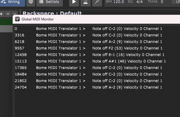

I have managed to get midi out of gig performer (i use the streaming audio player with markers and the markers trigger an action to send a note on midi message) and that goes via MTP and using the midi router and the virtual port, i can see messages coming into Resolume

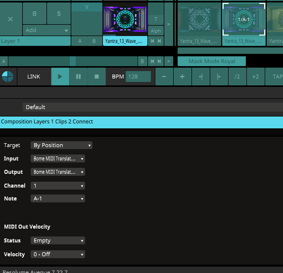

So far, so good!! However this is where things start to get a bit weird. Firstly, Resolume doesn’t seem to recognise these notes when trying to perform a midi learn. Ok, no problem, i will just set this up manually. i create a note shortcut to trigger the clip with the note value i see in the midi monitor.

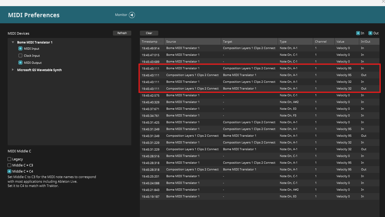

This seems to work if i have the midi input and output set to the bome virtual port BUT i am now unable to select any other clips as it immediately jumps back to the clip with the midi note shortcut even if that isn’t being triggered by gig performer at the time. its almost like a feedback loop of some kind where the output of the virtual port goes straight back into the input. Something weird like that anyway.

these are the settings and midi monitors in GP and Resolume. For the screenshot for Resolume with the red rectangle around 4 entries - these appear when i click on any other clips in the layers which then immediately snaps back to the one i have the midi assignment.
