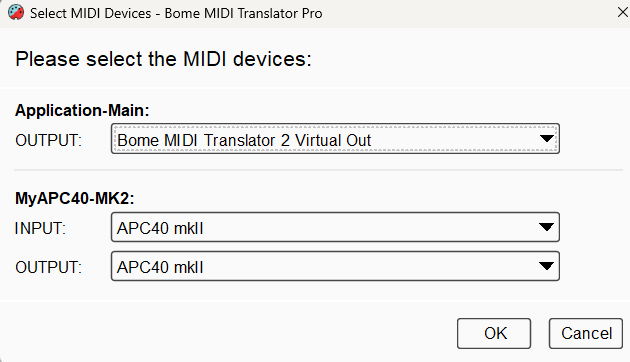

The attached project should do it.
My aliases are set up as follows:
Translator 0.3 sends a SysEx string that makes the APC-40MK2 all momentary. This is an interal mode of that specific controller. The translator is triggered by the perform ‘Init’ function. (Requires 1.9.0 of Bome MIDI Translator Pro or later). The mode value is constructed in the rules of translator 0.3.
Perform “Init” is triggered by translator 0.0 when the project is open (translator 0.1), if you enter a keystroke CTRL-Right Arrow, (translator 0.2), or when the APC-40 MK 2 MIDI port is opened (translator 0.4).
The following are possible modes of the APC-40 MK2. The programming manual can be found on the AkaiPro web site.

APC-40-MK2-Init-Mode2.bmtp (1.7 KB)
