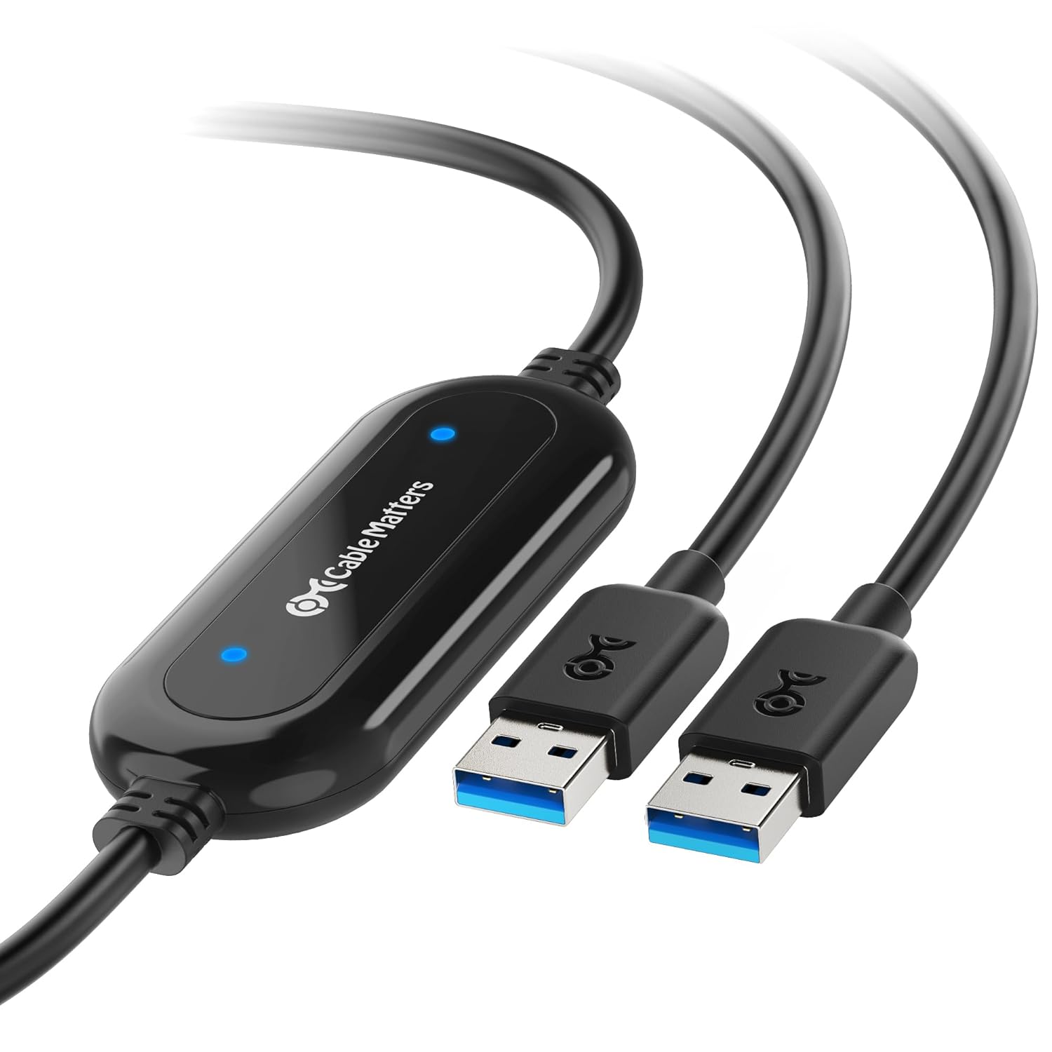

One of my (new) units - a Tasty Chips Integral pedal - has a USB Host interface. The documentation for the unit suggests a ‘host-to-host’ adapter to allow connection to another USB Host interface, such as on the Bome Box. I’m unclear on this … do I simply use a specialized Host-to-Host cable between the mioXL and the Integral … a device such as this (or any other device that you might recommend):
Cable Matters USB 3.0 Data Transfer Cable PC to PC for Windows, USB Transfer Cable in 6.6 ft - Easy Computer Sync Software Key Included, Works with Windows 11/10/8/7/Vista/XP, Compatible with PCMover

I’m at a loss for the right device to use to talk to this pedal, so I guess I’ll just go with one of these consumer type host-to-host cables and plug and pray …

I tested this device, and it does not work for my application (sending MIDI over USB between two USB Hosts, both with USB-A connectors):
https://www.amazon.com/USB-C-USB-Windows-Transfer-Cable/dp/B07S31ZR42/
