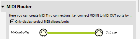

Hi and welcome back!
Yes, just draw a line from your controller to Cubase in the MIDI router. Anything with a translator will get passed through untouched.

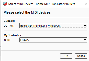

My Aliases are as follows:

I followed your suggestion and went into the MIDI Router tab. I created a connection between my input device (Arturia MiniLab 3) and the output (I’m using ‘Bome MIDI Translator 1’ as the virtual port that Cubase listens to). The passthrough works perfectly , all MIDI messages from the MiniLab are now going into Cubase as expected.
