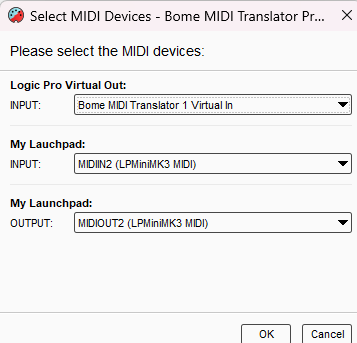

First I created different alias so not to conflict with the port naming that the LP MINI exposes. I set them up as follows. I’m running in user mode.

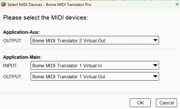

Here are the aliases I’m using.
I set up the presets to determine the desired input and output ports for the translators.
Make sure you have swallow set if you don’t want to use the MIDI thru paths.

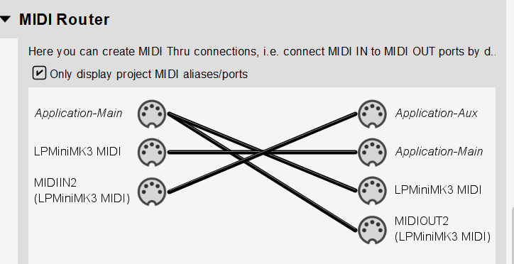

For MIDI thru (items without translators), I just have MIDI thru paths set as follows.
