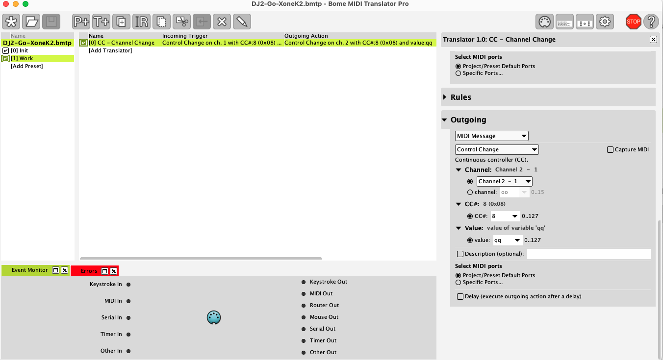

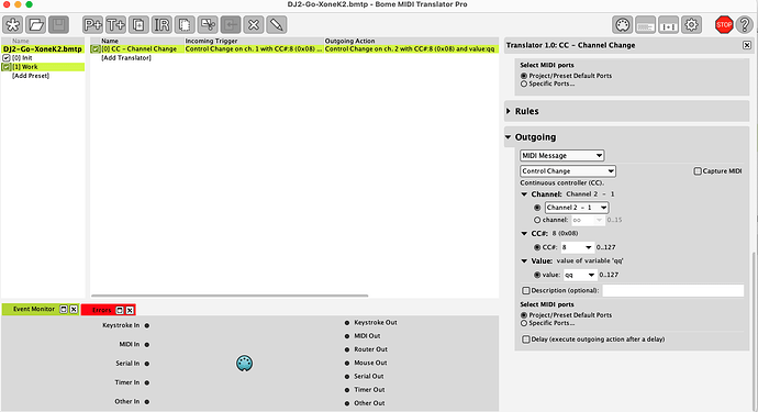

After you select the incoming message, you need to change the value to any value and then use a local variable (in this case “qq”) that can be passed to the output.
Then in the output message, change the desired channel you want to map it to and send the same variable “qq” as the value of the output.
Attached is an example.
Make sure you set up your aliases correctly.
Also the routing of the preset of translator.

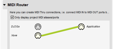

For the Xone K2, I just set up a MIDI thru route so that there is no translation.
See the attached project file.
DJ2-Go-XoneK2.bmtp (1.7 KB)

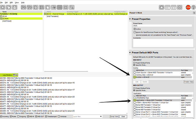

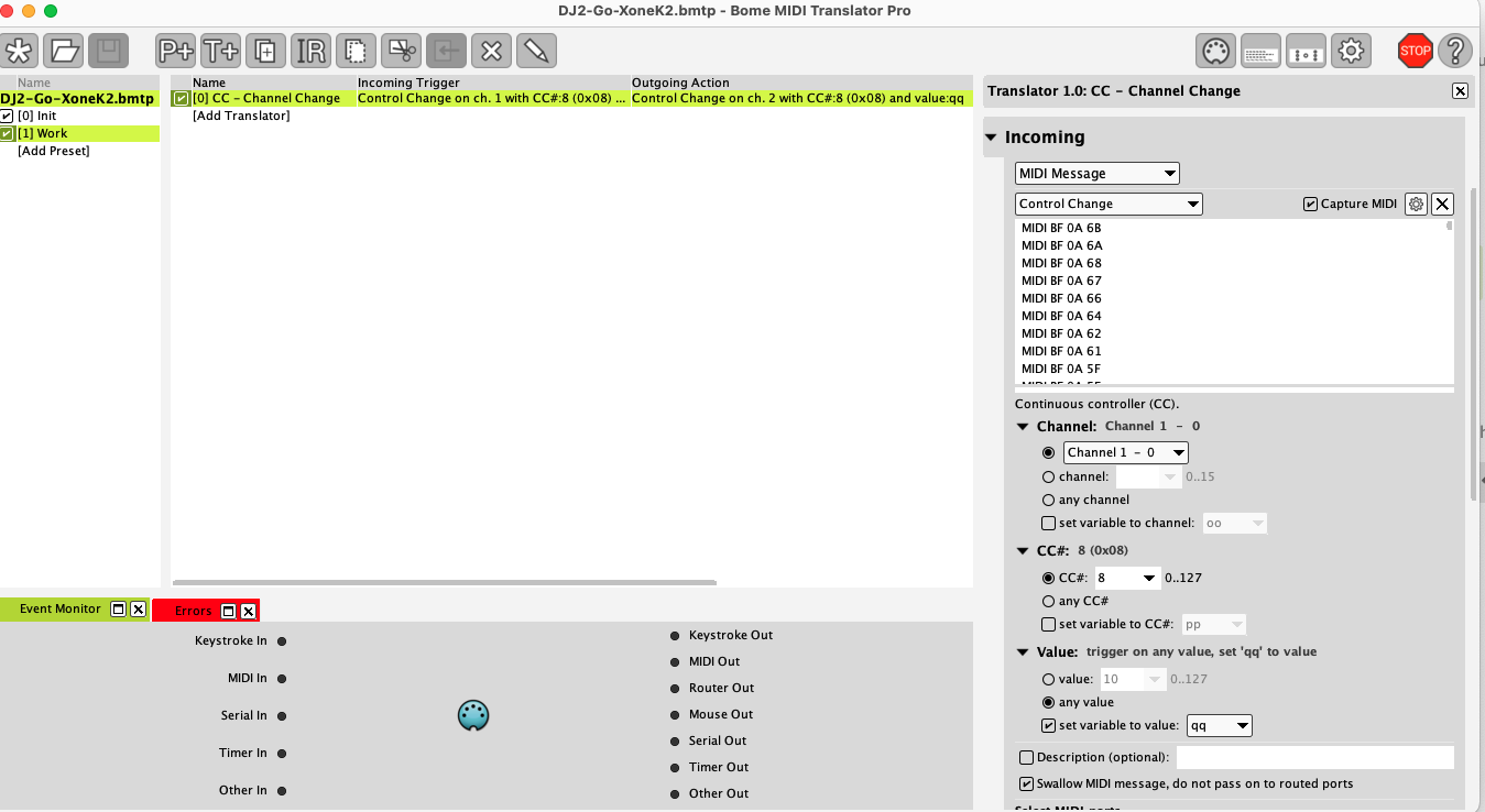

Ok here’s where i’m at:
the incoming:
when I turn the knob, I get all the messages in the incoming box. am I supposed to select one or all of them one by one and change the settings for them? If just one, which one ?

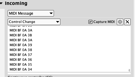

the list scrolls to here:
The outgoing:

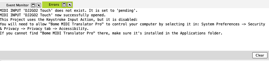

also got some errors I don’t understand. (I did give bome accessiblity access but I don’t understand the first one)

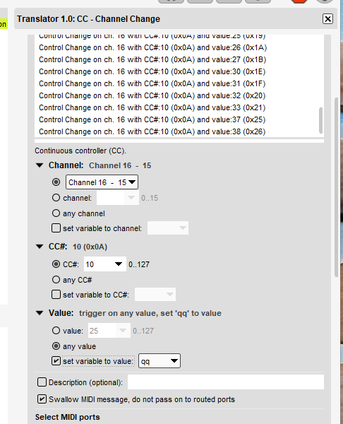

P.S when I do select one of the messages it turns into this:

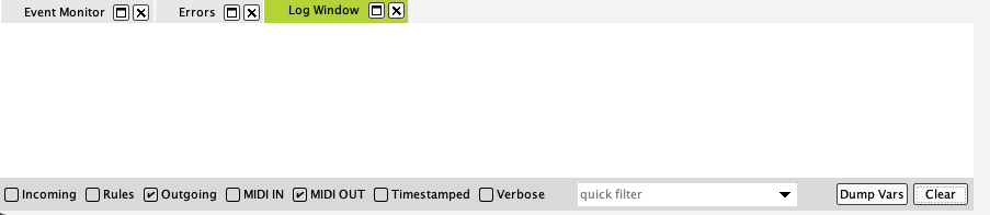

When I log out midi out, I get nothing after turning the knob. (but can see midi in)

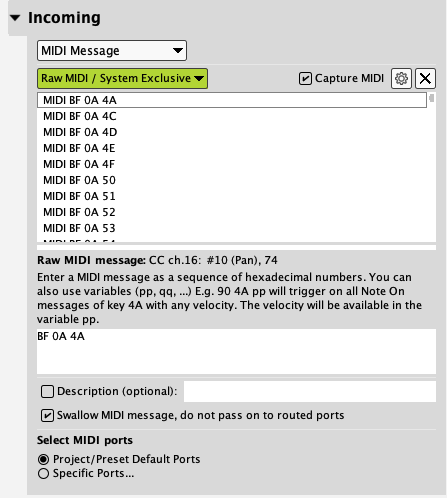

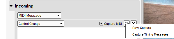

Right click on the cog Icon and turn raw capture off with a left click.

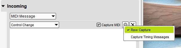

When you are done it should look like this.
Then you should see messages like this.
Click on one of the messages and it will transfer to the incoming.

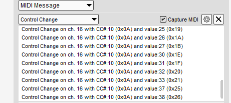

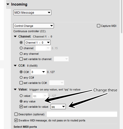

Then set the incoming to this. Any value set to qq.

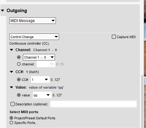

Finally set up the outgoing message to the MIDI Channel CC# that you would like with a value of qq.
In this example I’m setting it to CC1 on MIDI CH 1

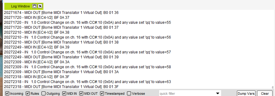

And here is what my log window shows.
That did it!!! Thank you so much!
