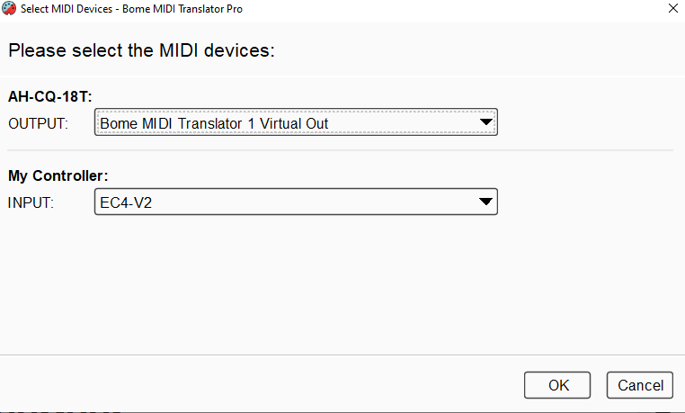

My aliases are set up as follows:
You would set them up to point to the correct physical ports depending on whether running the project on your computer or BomeBox.
