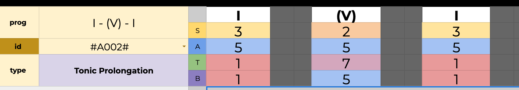

Hello, so I have a google sheet with a large database of chord progressions, each consisting of an “x” number of chords that each have 4 voices. each voice have a number that identify which note it is (F major is the reference here)
each chord progression have a unique id “#A002#” for ex.
I have a local python script talking to the google api to pull in realtime the value of that cell everytime it changes, they the id value is sent to keyboard maestro with a webserver and stored inside a variable. Now I will create a lookup table inside keyboard maestro, to send a different value to bome depending on the id.
