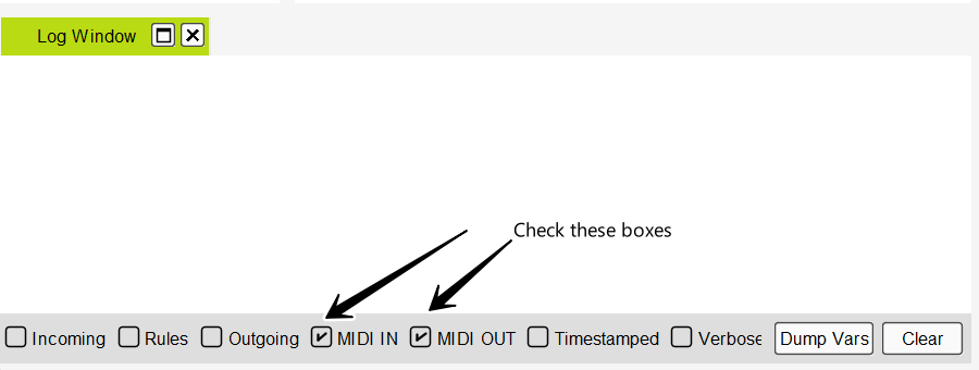

Could you please hook up your controller to Bome MIDI Translator Pro and then press and release the button in question? Please enable the MIDI IN and MIDI OUT check boxes in the log window.
Make sure that you have selected your MIDI controller for input.
