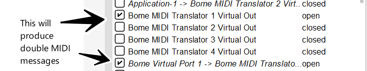

Also, since you are selecting both Bome MIDI Translator 1 Virtual Out and Bome Virtual Port 1, you would be sending double messages since Bome Virtual Port 1 is an auto aliase for Bome MIDI Translator 1 Virtual Port (for backward compatibility).
I’m not sure about Mac, but on Windows I like to use F13-F24 since they are widely not used anywhere else. You might need a programmable keyboard or a program to produce these keystrokes however. You should select one or the other but not both otherwise you will get double messages.
