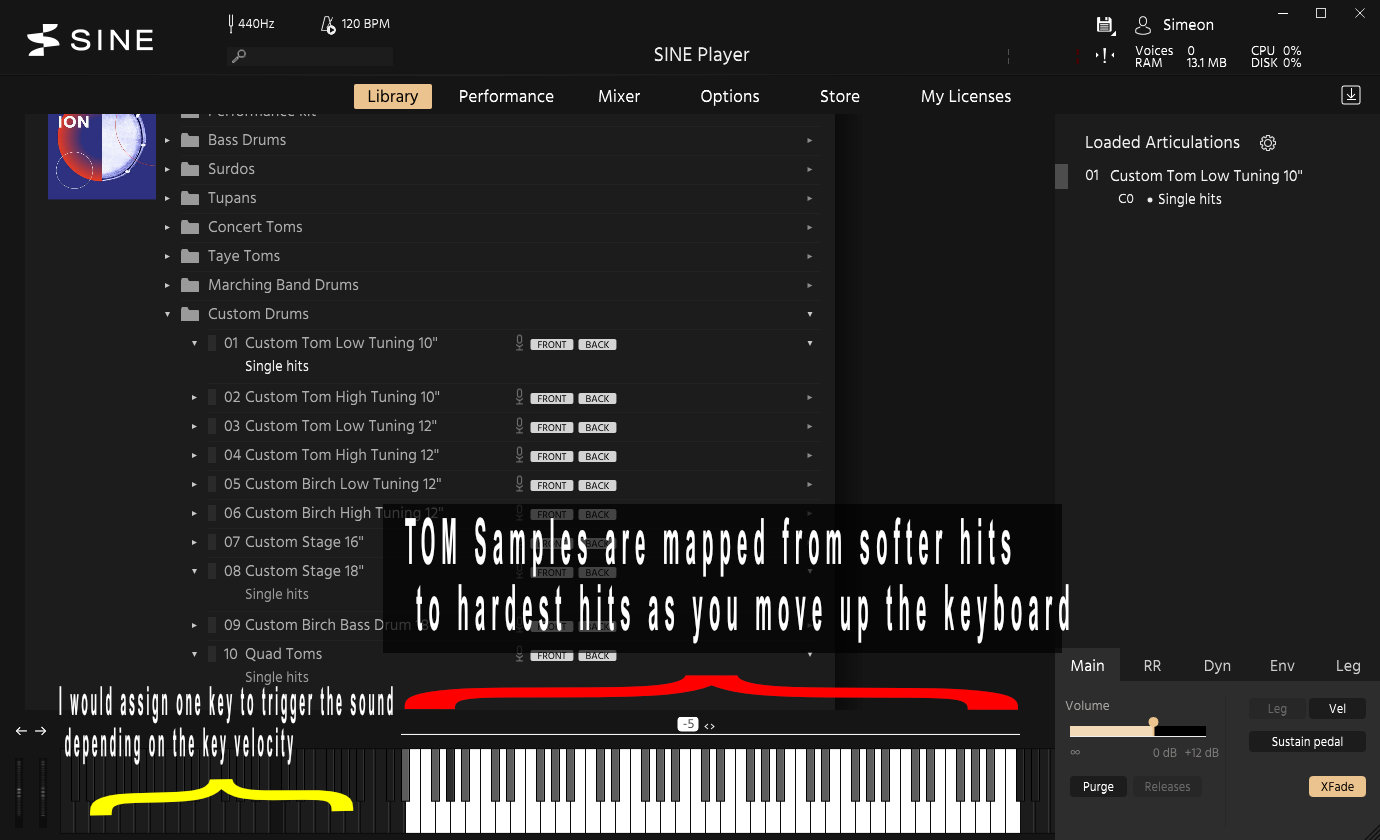

I am using a virtual instrument (Orchestral Tools Tom Holkenborg Full Contact Percussion) that maps single drum samples throughout an extended key range to map intensity:
Softer drums start let’s say at C3 and as the note range increases so does the amplitude of the drums.
I would love to be able to play a single note (C2 for instance) and according to the velocity I play, it would trigger a corresponding note above to trigger a drum part that would match a certain velocity range.
Here is a screen grab to help explain.

Another option that would be nice is to have more than one key assigned to a specific drum sound so you can do rolls using adjacent keys in the lower triggering area.
You would trigger notes down below to play a range of notes above based on the velocity of the lower notes being triggered ;^)
