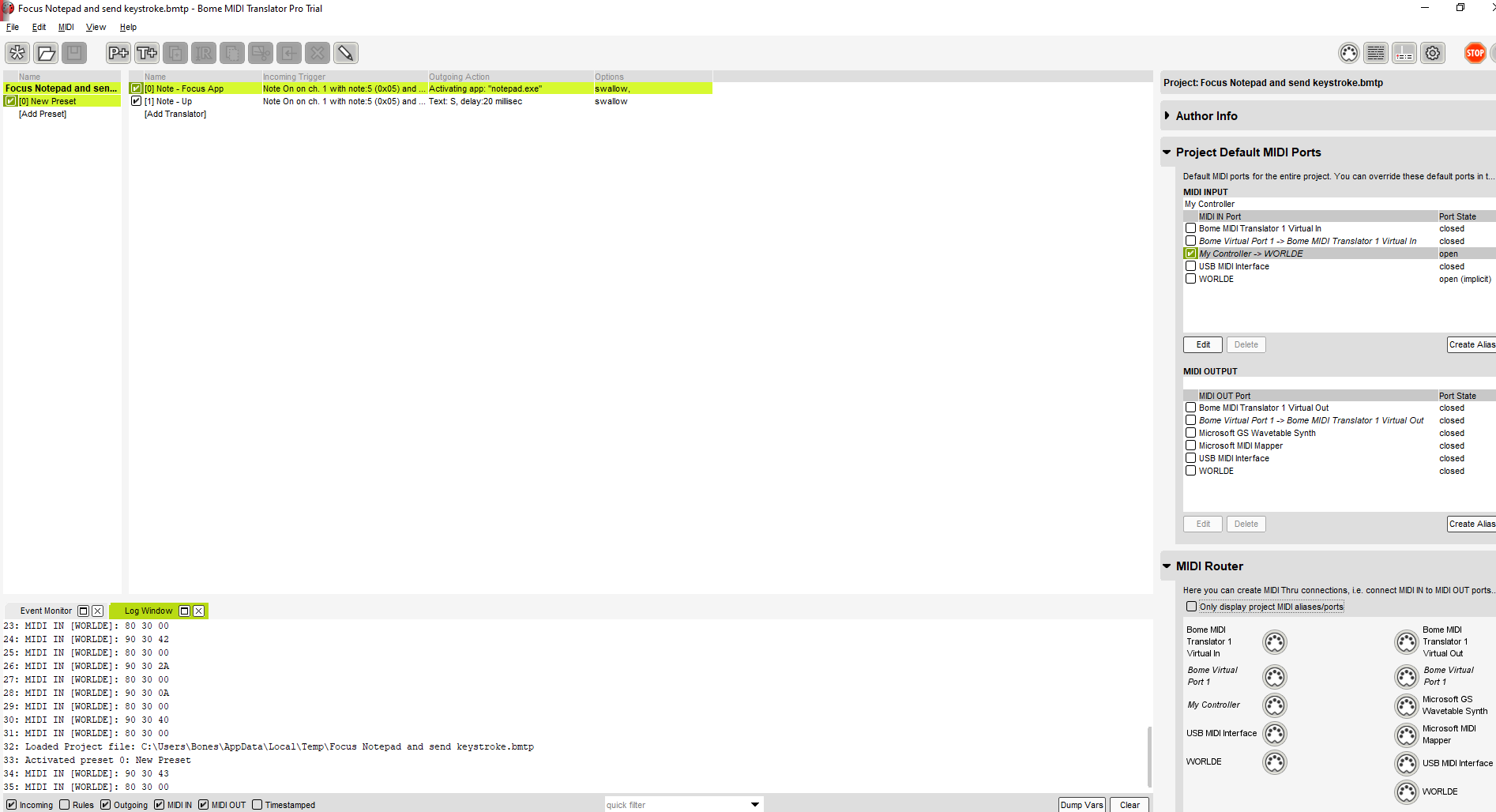

Can you enable logging and enable “Incoming”, “MIDI IN” and “Outgoing” and show me a screen shot of what you see?

even with the implicit checked nothing

Yes, looking at MIDI In you are not sending Note # 5 so it will not work that way.
You are sending note 30(hex) with is note 48 Decimal. Change the incoming Note to note 48 and it should work for you.
Alternatively you can click capture MIDI message and then click on the desired message to pull the incoming message into the incoming trigger.
And the project file.
Focus Notepad and send keystroke-Note-48.bmtp (1.2 KB)
