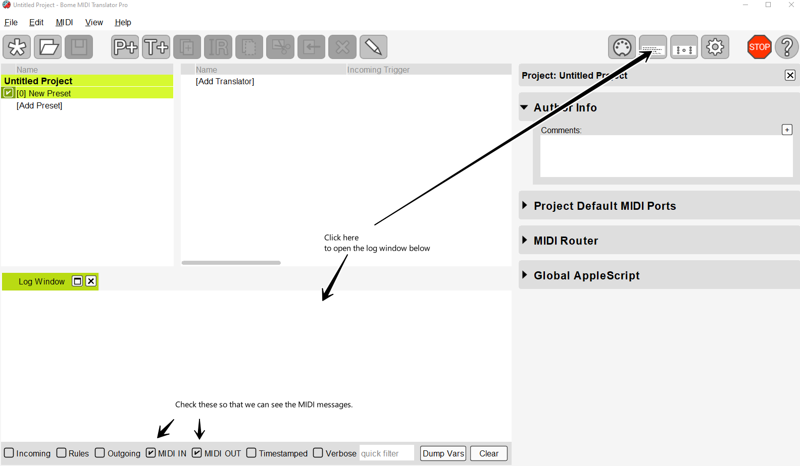

To further assist, I would need to perhaps see your project file and maybe you can open the log window and show the MIDI IN and out that you are seeing.
I would need to see a screen shot what you are using in GrandMA2 as your MIDI IN device, to ensure it is the same output from Bome MIDI Translator Pro .
