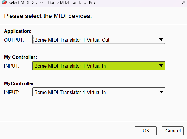

I set up my aliases as follows but you will need to set them to your devices.
I set up my device selection at the preset level.
