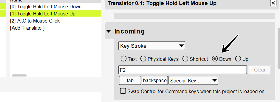

I changed the project so that both translator 0.0 and 0.1 accept F2 Down as an incoming trigger.
Keep in mind that if your computer is programmed to otherwise process F2, the original outgoing keystroke is NOT suppressed so be havior may change depending on which window has focus. It is best to use a function key that doesn’t natively trigger anything else within your application or operating system.

Thanks a lot, it work as I wanted now!
Yes, I’m aware that the original keystrokes are not suppressed, that’s the reason why I choose F2 because I disabled it in the software where I intend to use this translators.
