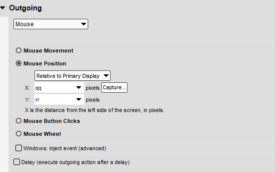

A midi note triggers to move the mouse to specific coordinates
Is there any logic or type of formula you would use to determine the mouse coordinates or would it just be a random mapping.
For a random mapping, something like this would work
Incoming: Note-ON MIDI CH1 set Note to pp
// Lets say note number is pp, qq=x and rr=y
// see if the note maps to anything
// default qq =-1
qq=-1
if pp==25 then qq=15
if pp==25 then rr=123
if pp==26 then qq=23
if pp==26 then rr=18
//...  add more note conditions here.
if qq<0 then exit rules, skip outgoing action

EDIT: Okay I tried and it seems to work : the click trigger the pad but the note is very short.
is there any solution to make the click or the note longer ?
Do you click on the pad? Maybe you need a click “down” action and then a delay with a click “up” action. Or maybe click “down” would be with note-on and click “up” with note off.
Maybe you can share the project file.
‘Or maybe click “down” would be with note-on and click “up” with note off.’
great idea ! how can I do that ?
With 2 Translators. One clicks down at the desired position with note-on (Translator 1.0). The other sends click up on note-off (1.1).
See the attached example.
