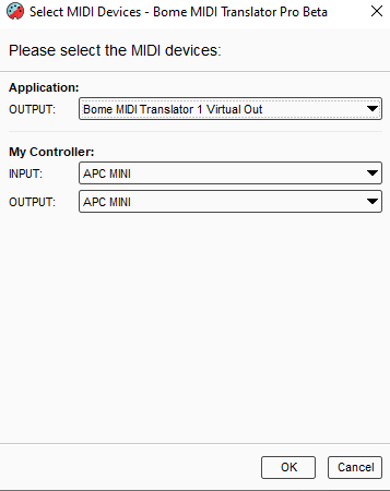

I set up my aliases as follows:
I know there is a lot of moving parts here for a new user so perhaps if you can describe the MIDI channel, note number and gesture you want for a given button, I can modify the project file to align more with your needs.
In summary, preset 2 handles the counting of given pressed and released buttons using a timer and preset 3 handles the evaluation to determine the action you want to take with a given button and gesture.
