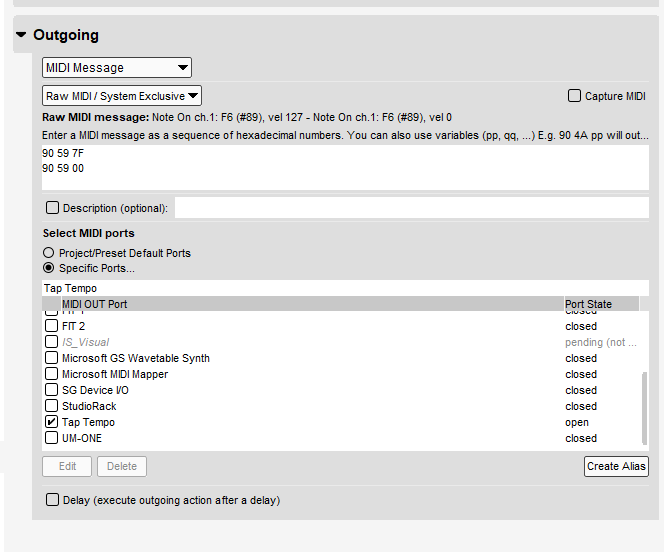

Yes, so from Ableton, make sure Sync is turned off on your MIDI output so it’s not sending MIDI clock to LV1 and then what I did was have a simple MIDI note (I chose F#7) trigger in Bome to send over a Raw MIDI:
90 59 7F
90 59 00
That will trigger the tap tempo button. It locks in after 2 but I have for notes trigger at the start of a song. After that you can just drop that MIDI clip into any song you want tap tempo locked in.

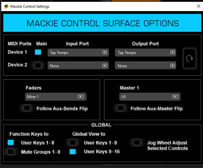

On the LV1 side, I set up a Mackie Control surface and pointed it to the network I sent out from Bome.

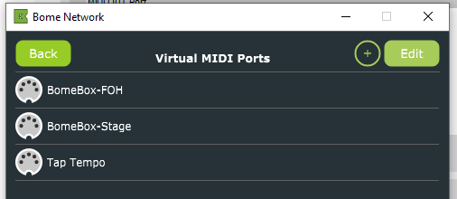

I created a virtual midi port called ‘Tap Tempo’ in Bome Network so that I’d have a dedicated midi input for it. The Mackie will select it, but when I load the project to the bomebox, the tap tempo is not triggered.

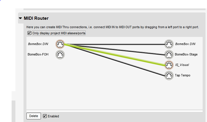

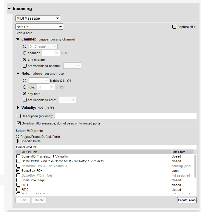

Thanks for the help! I went into the MT Pro project and assigned the routing as you suggested, but I’m still not getting any MIDI coming into LV1. I’m a little stuck here.

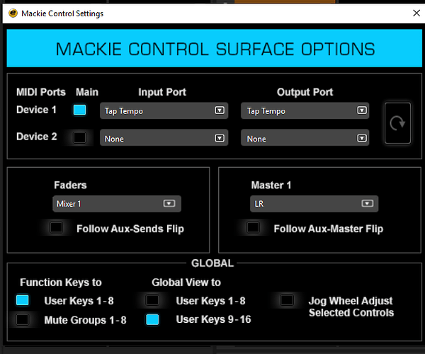

I have MIDI being sent out of Logic into the Bomebox (‘FOH’) which should then be translated into Raw midi Tap Tempo signals and received by the (virtual) Mackie Control in Waves LV1.
I created a virtual midi port for the Mackie in LV1 called ‘Tap Tempo’, see some screen shots below:
I then did the routing in MT Pro:
With these settings in MT Pro:
I get no signals anywhere for some reason. I occasionally managed to get it working by keeping MT PRo running and changing the mackie ports to MT PRo Virtual, but that doesn’t seem solid and I should be able to achieve this on the bomebox standalone, right?

What is the routing for your newly created “Tap Temp” port on your computer?
When you create virtual ports with “Unlimited Named MIDI Ports,” only the endpoints are created but there is no routing between the endpoints.
So in the Bome Network MIDI tool you need to set up a route that looks like this.
Then any MIDI going into “Tap Tempo Virtual In” coming from Bome MIDI Translator Pro will go to “Tap Tempo Virtual Out” which is received by LV1.
For more information on how this works, see this post in Tips and Tricks.
