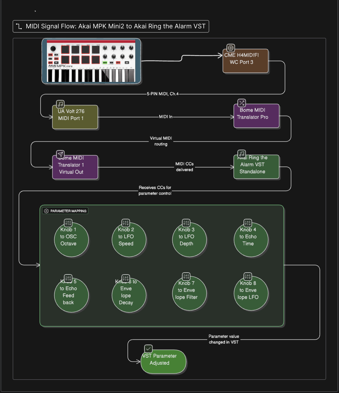

I bought Bome MIDI Translator Pro to map the knobs of Akai MPK Mimi Mk2 to Akai Ring the Alarm VST in Standalone mode. I use CME H4MIDI WC to map the default midi channel from Default MIFDI Channel 1 to midi channel 4. Then I send that to UA Volt 276 5 pin port on the back of the interface. From there I output to Bome Virtual Port 1> BomeMIDI Translator Virtual Out. My goal is to control the knobs on the Ring the Alarm VST in Standalone mode.
Please help me with this project.

issues: Akai Ring the Alarm VST in Standalone Mode
Unable to find data on midi data to turn knobs
Keys enabled automatically but no knobs or info about what will make the knobs turn.
          Akai MIDI Editor for MPK Mini MKII only 32 bit crashes immediately-Worthless.
            BOME is my only hope !!!

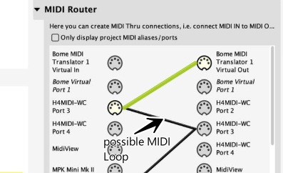

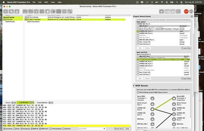

Hi, is there a reason you are passing this through the Volt 276? I see you also have a MPK MIDI MK2 input (probably USB). Why not just use Bome MIDI Translator Pro pass the signal directly to your plugin? Maybe you are also controlling something on the Volt 276 with your MPK?

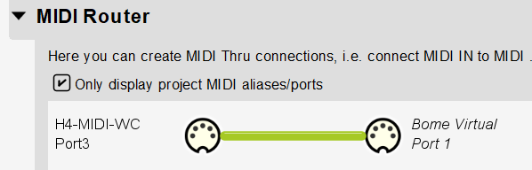

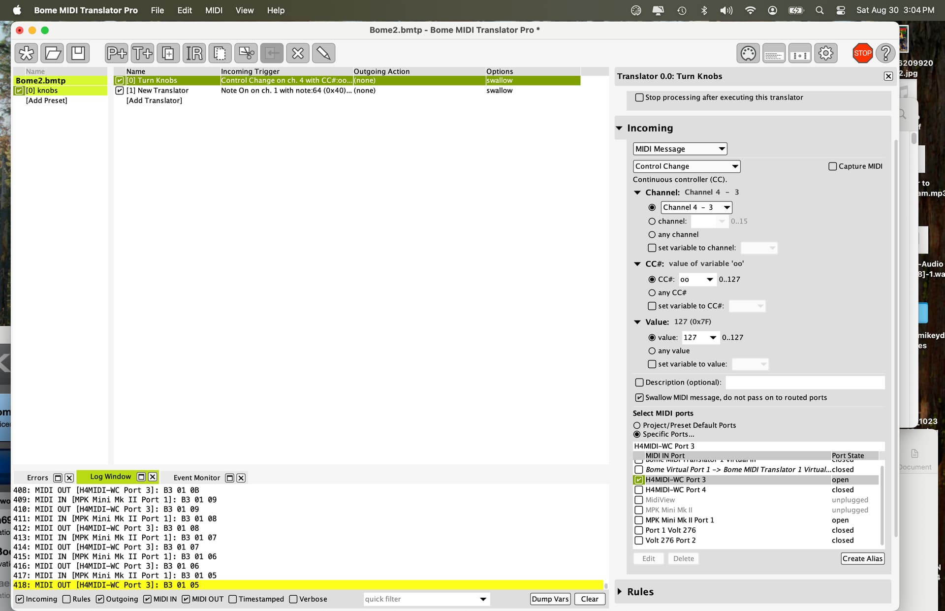

The attached file will convert convert any CC on MIDI Channel 4 coming in to the same CC on MIDI Channel 1. I
I don’t understand all of your router MIDI through paths and things are likely crashing because you have a MIDI loop somewhere. Maybe this path.

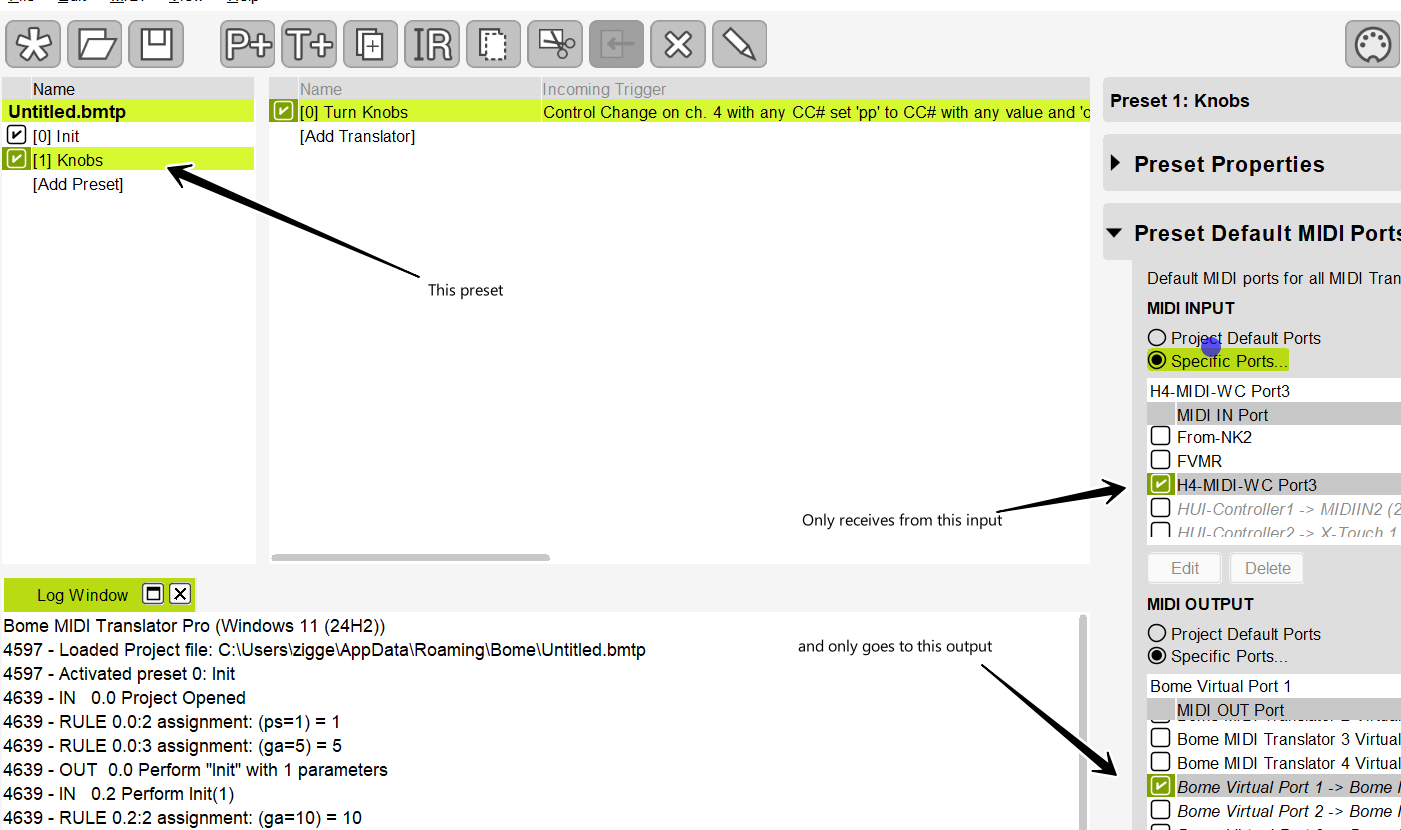

In the attached configuration, anything other than a MIDI CC will be passed through to the virtual port untouched. I only have one MIDI thru path set and the preset is set to only read from H4-MIDI-WC Port3 and send only to Bome MIDI Translator 1 virtual port.
I only have on MIDI thru path (for any other CC messages)
I am not looking at input from other ports.
H4-MIDI-WC-Port on CC 4 to BMT1 Port 1.bmtp (1.8 KB)

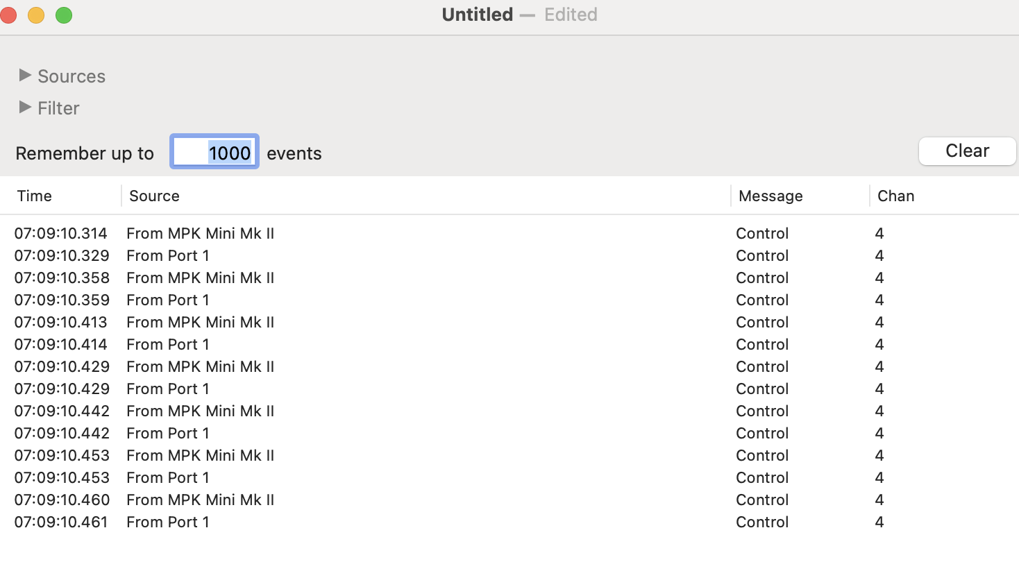

How do I proceed with manually entering the location of the mouse. What do I do to, first of all, find the location numbers? Then I enter them exactly where in the rules?

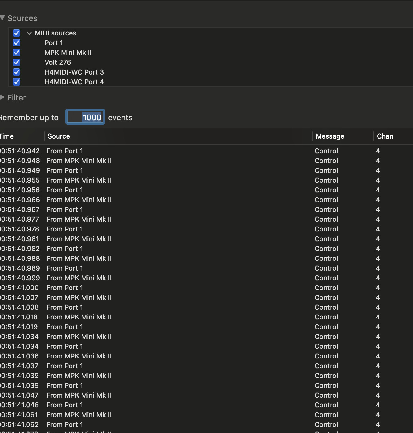

also in MIDI monitor it shows Port 1 (MIDI in on Volt 276) and MPK Mini Mk II but no H4MIDI WC.

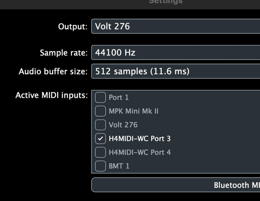

In the Settings for Ring the Alarm it has Activ eMIDI inputs
Since you are sending H4-MIDI-WC Port 3 outside of Bome MIDI Translator Pro, and it is not seen by the Mac (outside of Bome MIDI Translator Pro) , you will have to figure that out on your Mac, you will probably need to route it using the MIDI Studio settings on your Mac.
It looks like the Ring the Alarm app sees that port and should be able to access it (for notes only).
