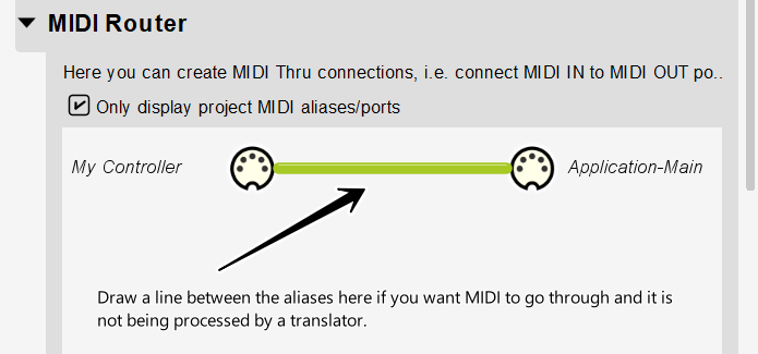

Hi, when you look at the log, any output with “Outgoing” checked, will only show if it is going through a translator. If you check “MIDI OUT” it will show whether it goes through a translator or not, but you won’t see it if there isn’t a “MIDI thru” path set in the MIDI router. Do you have a MIDI thru path set up in the MIDI router?
