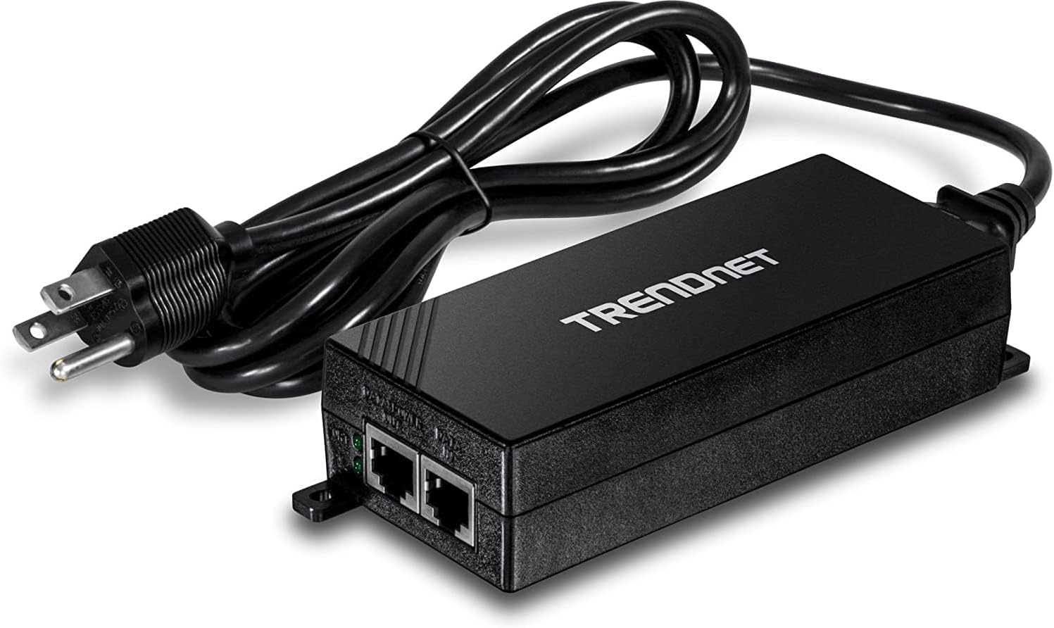

Thanks for the fast response. Here is the PoE+ injector that I used. It would be nice i you guys would list PoE injectors that you have tested with on the website. Being that not all injectors are the same.
This is a mystery! On paper, the injector is compatible. Over the years, we’ve tested with dozens of different injectors and PoE switches. We’ve never had a problem at all. And to my knowledge, our customers have never reported a problem with PoE. That’s why we don’t maintain a list of good or a list of bad PoE power sources.
