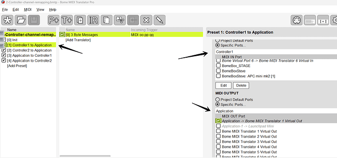

Please find the attached. I set up aliases as follows.

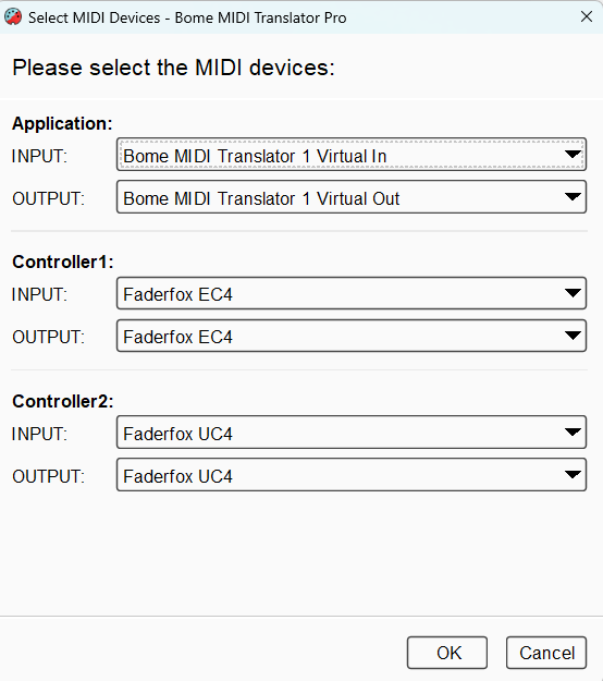

You will need to assign them for the controllers that you are using as well as the application.

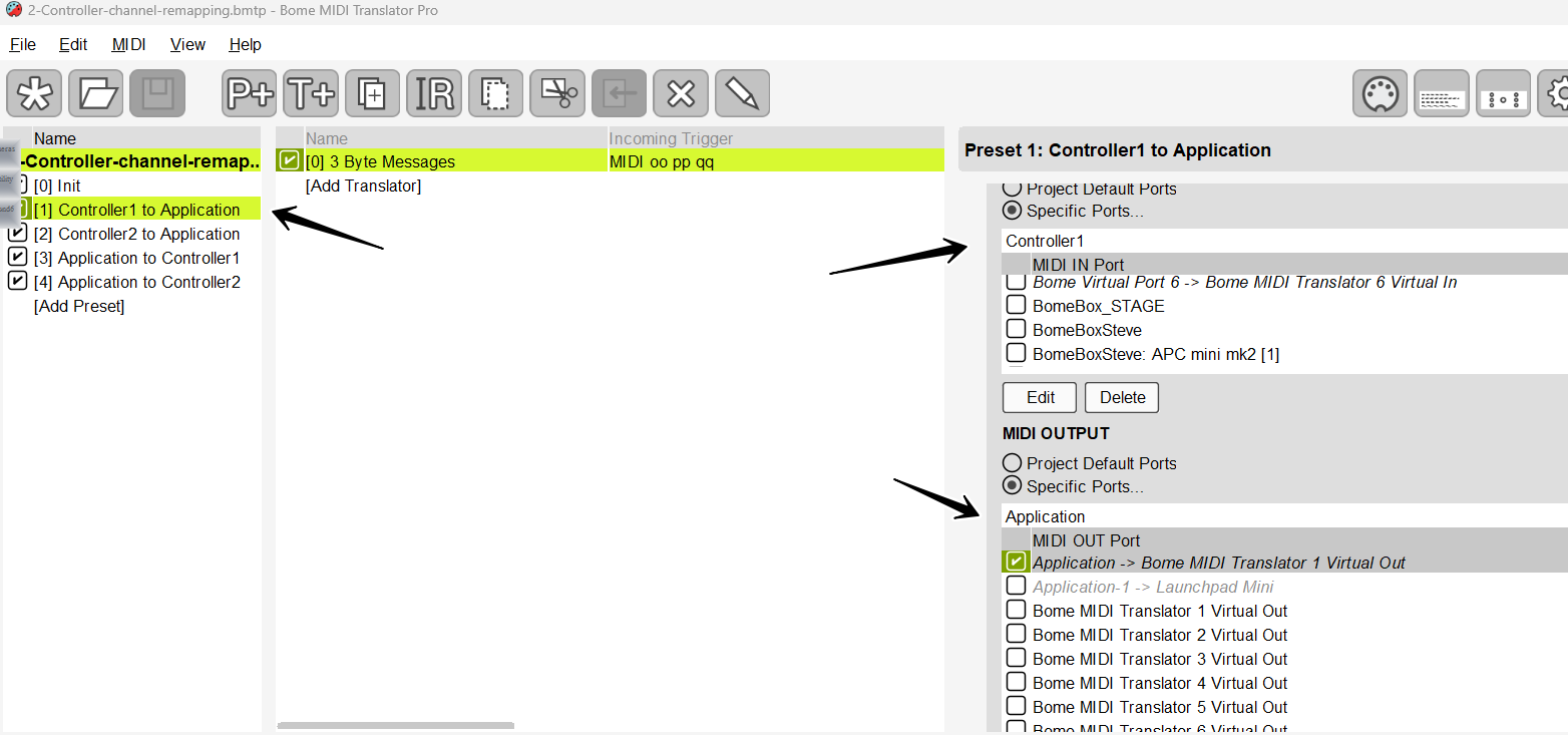

I then created 4 presets. Each preset only receives to and sends to the given target MIDI port.
For instances translators within the “Controller1 to Application” preset will only accept messages from the controller assigned to the alias “Controller1” and only send to the alias assigned to “Application”
In each preset, I have a single translator that converts any 3 byte MIDI messages to the MIDI Channel of your choice.
The below is for preset 2 and will convert any 3 byte incoming message on MIDI CH 1 to the same message on MIDI CH 2. I use rules to determine the accepted incoming MIDI channel and outgoint MIDI channel.
Here are the rules of translator 2.0

So essentially:
  • Translator 1.0 receives from MIDI CH1 on Controller1 and sends to MIDI CH1 to the application.
  • Translator 2.0 receives from MIDI CH1 on Controller2 and sends to MIDI CH2 to the application
  • Translator 3.0 receives from MIDI CH1 from the application and also sends on MIDI CH1 to Controller1
  • Translator 4.0 receives from MIDI CH2 from the application and sends to MIDI CH1 to Controller2
If you need to pass 2 byte messages, you could just model the existing translators for that. Three byte messages will handle notes and CCs. If you use PC you will need 2 byte messages. If you need MIDI clock, you will need 1 byte messages but there is no channel information on single byte MIDI messages.
2-Controller-channel-remapping.bmtp (3.8 KB)
