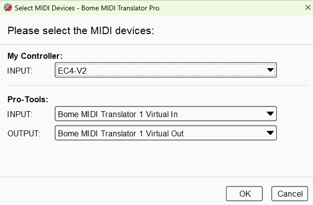

The first preset (preset 0) has translator 0.3 which will set a HUI ping reply when Pro-Tools sends a Ping. This tells Pro-Tools that there is an attached HUI device.
Preset 1 has 2 translators.
The first translator sends a HUI Stop signal when Note on MIDI CH 1 note 12 is sent from your controller.
The second translator sends a HUI Play signal when Note-On MIDI CH 1 not 13 is sent from your controller.
You can modify the incoming triggers based on what your controller sends for these functions.
I’m using the following aliases.
For input output device selection, I define the devices at the preset level.
For the HUI ping and reply, I define the devices at the translator level.
You can download a trial copy of Bome MIDI Translator Pro here to test it out. The trial version is fully functional but times out every 20 minutes.

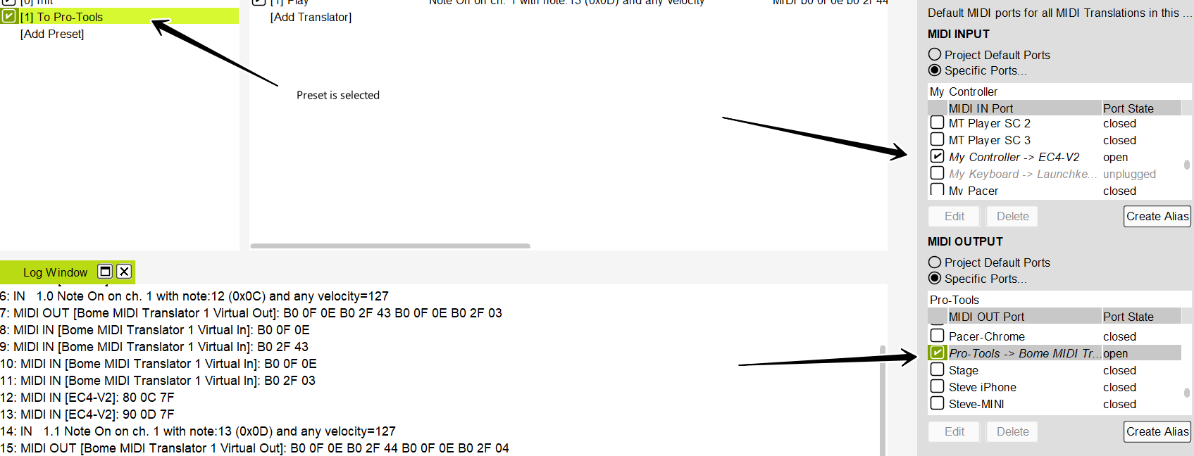

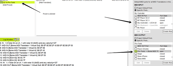

So you are converting incoming MIDI message to keyboard shortcuts in ProTools. It is important that you have a translator that makes sure ProTools have focus before sending computer keystrokes.
Thanks for the update!
I basically just duplicated the Translators you made me for the ‘Start and Stop’-preset, changed Channel, Note and outgoing message.
So for ‘Up/Previously’ I wrote:
b0 0f 13 b0 2f 45
b0 0f 13 b0 2f 05
b0 0f 15 b0 2f 43
b0 0f 15 b0 2f 03
Does this make sense? or did I make any mistakes here..?
HUI MIDI for Up would be:
B0 0F 0D B0 2F 44 - For press
B0 0F 0D B0 2F 04 - For release
If you what to send an outgoing keystroke, you would just learn the computer keystroke that you want to send.
