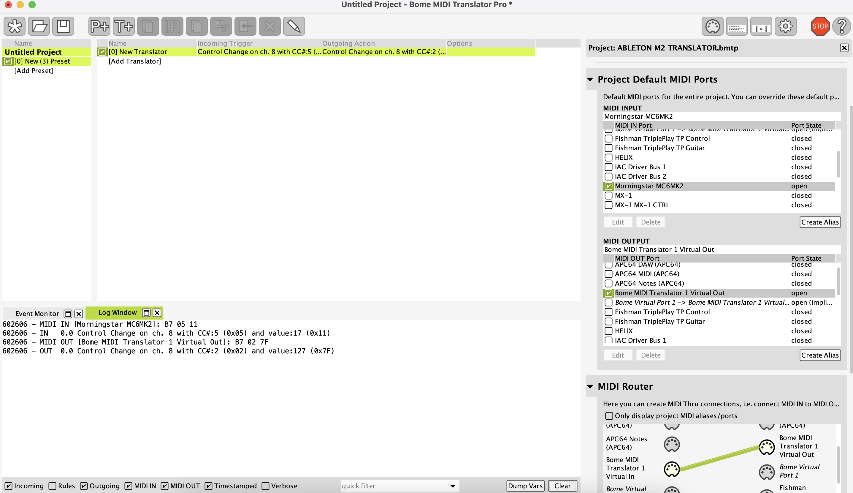

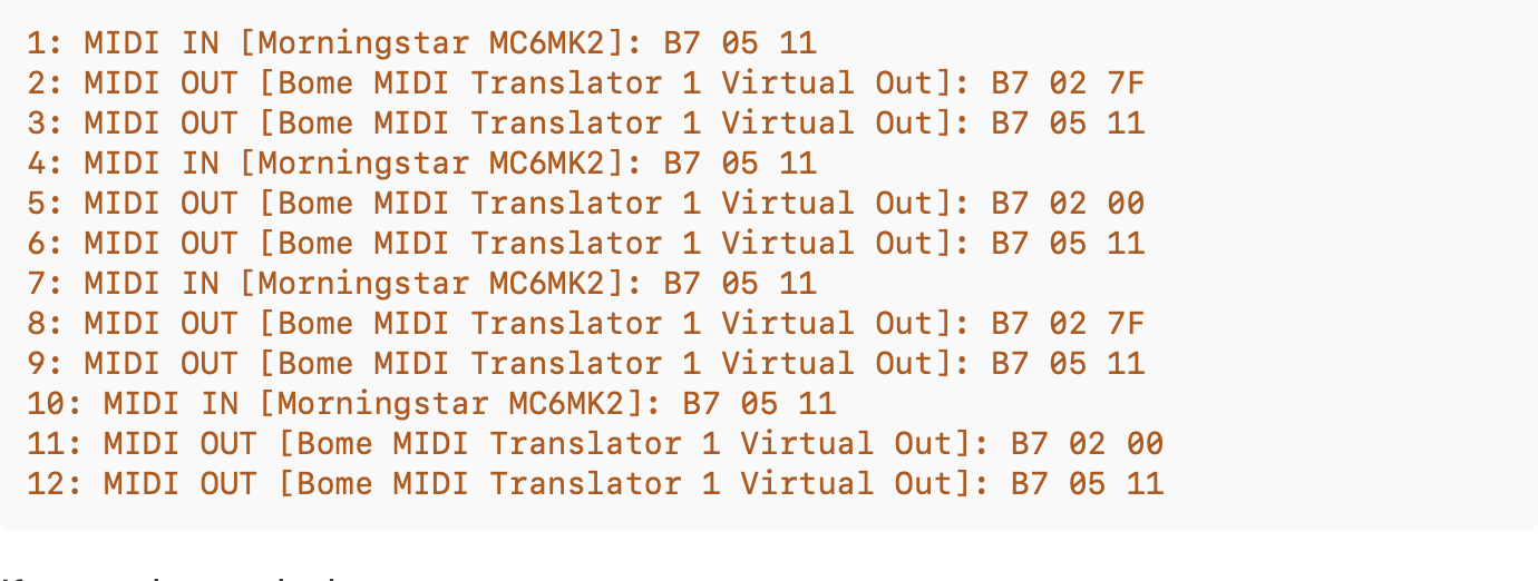

Is this what you want?
1: MIDI IN [Morningstar MC6MK2]: B7 05 11
2: MIDI OUT [Bome MIDI Translator 1 Virtual Out]: B7 02 7F
3: MIDI OUT [Bome MIDI Translator 1 Virtual Out]: B7 05 11
4: MIDI IN [Morningstar MC6MK2]: B7 05 11
5: MIDI OUT [Bome MIDI Translator 1 Virtual Out]: B7 02 00
6: MIDI OUT [Bome MIDI Translator 1 Virtual Out]: B7 05 11
7: MIDI IN [Morningstar MC6MK2]: B7 05 11
8: MIDI OUT [Bome MIDI Translator 1 Virtual Out]: B7 02 7F
9: MIDI OUT [Bome MIDI Translator 1 Virtual Out]: B7 05 11
10: MIDI IN [Morningstar MC6MK2]: B7 05 11
11: MIDI OUT [Bome MIDI Translator 1 Virtual Out]: B7 02 00
12: MIDI OUT [Bome MIDI Translator 1 Virtual Out]: B7 05 11
If so, see the attached.
I’m using the global variable ga to toggle between 0 and 127 for each input message. Not sure if you want that or not.
I have a MIDI thru path set to alias ‘Application Main’ which is set to Bome MIDI Translator Virtual 1 port.
I have unchecked ’ swallow’ so that the original messages goes through.

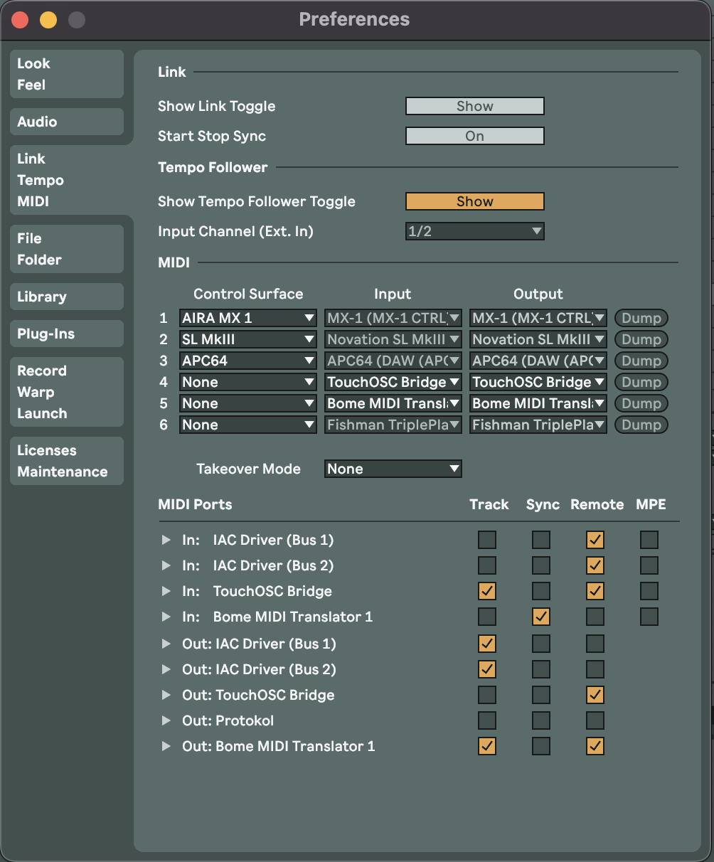

In Ableton you are checking “out” and should be checking “in”.
Out for Bome MIDI Translator Pro is In for Ableton Live.
Multiple-messages.bmtp (1.8 KB)
If you are using MIDI Learn in Ableton Live, you should only allow one message to go through when you are learning the control.
Disable the translator to leard CC 5 value 17.
Enable the translator and disable swallow to learn CC2.

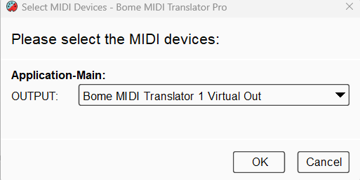

I created an alias for the project per your directions and have it checked as the output port.

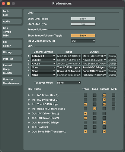

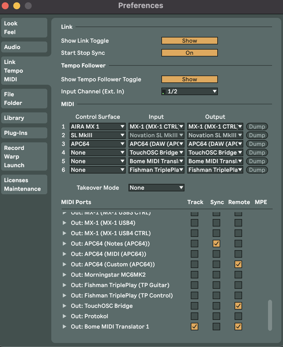

I failed to show the Bome input on the previous post. This is a more accurate view of my MIDI in/out preferences in Ableton. Hopefully it lines up:

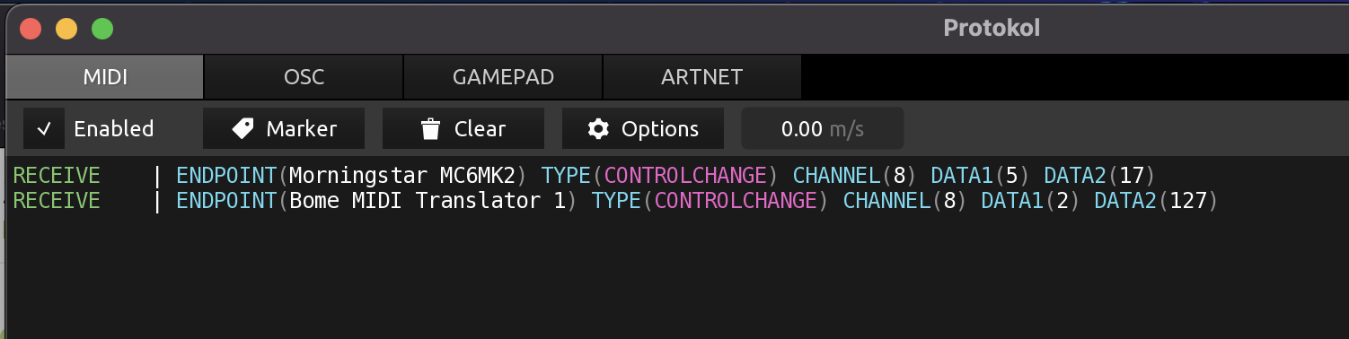

And this is a screenshot of my MIDI monitor when I send the message, but Ableton simply won’t respond to the translation.
Strangely enough, the swallow function on the specific translation has no effect, as well. I’m not sure if that’s related or not…

You need to choose remote for “In: Bome MIDI Translator 1” and probably uncheck Sync.
For out, unless you are sending MIDI from Ableton back to Bome MIDI Translator Pro you probably don’t need to check either Track or Remote for “Out:Bome MIDI Translator 1”.
Make sure Morning Star MC5MK2 is not checked anywhere in Ableton Live as you are routing from it to Bome MIDI Translator 1.
For the IAC ports I was previously attempting to solve the problem by creating a path for Ableton to trigger CC messages to itself… but, it’s now working! Your advice on proper routing paths in Ableton helped. I think I understand much better how I should be routing in Bome.
